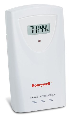

As long as you're throwing money around, you may want to consider getting a thermometer/hygrometer for the area you'll be working in. I use these widgets...
...because I have the base station that will communicate with several of them as well so I can see the temp/humidity in several places around here. But, since the unit is not quite as fancy as some, it costs a bit less and still accurately tells you what you want to know. There are certainly plenty of other units out there to choose from.
The reason you want one is it's important that you don't try to apply finish in a less than ideal environment. Not paying attention to that will either return less than stellar results or you can wreck it entirely. Plus, once you get the feel for things, just knowing what the temp/humidity actually is tells you a lot about how far to thin or retard your mixes so they go on smooth and don't sag, run or orange peel too much. Better to wait for weather to improve than to spend hours and dollars repairing a finish that perhaps should never have been shot.
