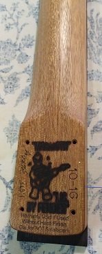

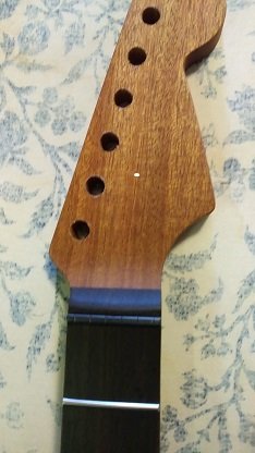

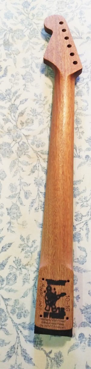

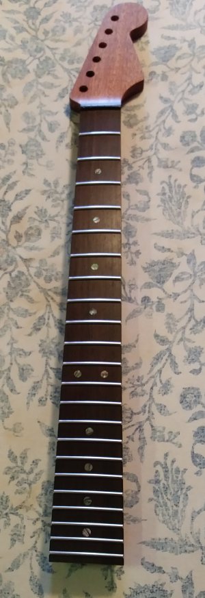

Stratmania As long as the neck shows up with the right measurements and materials I don't worry about warranties.  may Tru-oil the head stock but I may leave the back of the shaft alone for now. These are pictures of how it arrived out of the box. I'm not sure if you can see the red tint. When I sanded the neck most of the red disappeared. I don't know if there is some red tint on the buffer wheel or if the heat from buffing brings out the red tint. And just to be clear I did not sand the heel at all so I haven't changed the heel size at all.

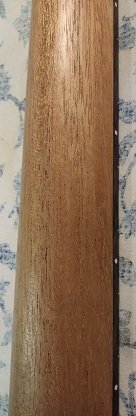

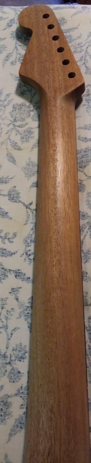

  Here are a couple of pictures after sanding to show the change in color. I liked the red tint but I like the plain tan wood shade also.

Nice neck.
I mention the warranty aspect for the benefit of others who may read the thread as much as anything else.
As I said you may not be bothered about the warranty but really there is a reason a finish is recommended for mahogany. Truoil on the headstock alone is going to do nothing to help against moisture and dirt getting into it from elsewhere. Its your neck but don't say nobody warned you if your plan doesn't work out.
