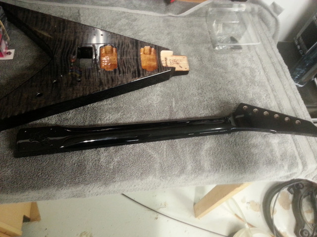

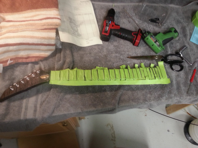

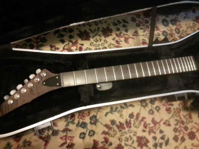

I started with the neck:
Not much to do, I reversed and installed the sperzel tuners and leveled and dressed the frets. Uneventful but the neck turned into this beauty

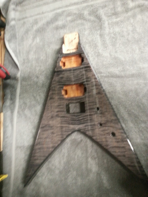

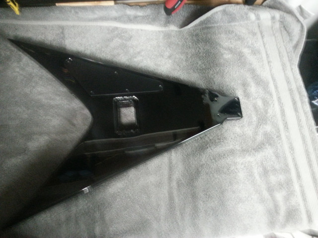

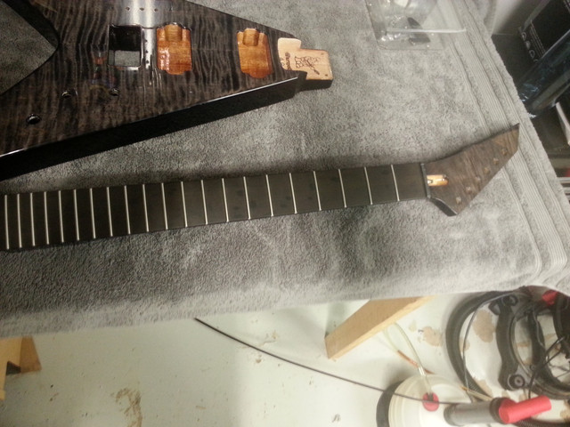

I then started on the body.
I first drilled all of the holes required to mount the pickup rings. I did the black metal ring on top of the black plastic ring for both and I also drilled holes for the Schaller strap locks. Originally I had put the strap lock on the side of the guitar but this was causing severe neck dive issues so later put it on the back as close to the neck plate as possible. This fixed the neck dive.

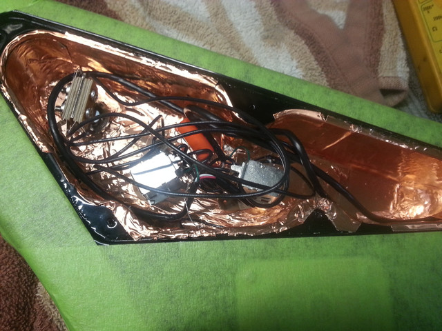

I installed the hardware and electronics, I installed a 2tek bridge and put in a 59 for the neck and a JB for the bridge and went with some alpha linear 500K long shaft pots in the end. The wiring in this thing went through 2 iterations. Here is the first.
This was a phase shift and series parallel wiring setup I had going for the first time. However, I found that the tone differences weren't really noticeable and I did not like the audio taper behavior of the original pots, it was also difficult to find switchable pots with long shafts and linear behavior so I ditched that and went with the alpha pots and a basic two humbucker 3 way switch setup which somehow ended up looking more complicated even though it was far simpler. I don't have a picture for it though.

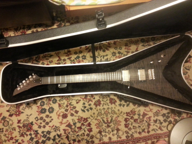

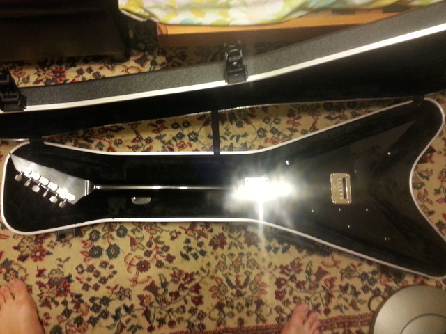

Then came final assembly and setup. I did the usual stuff including cutting the nut down. Put some Cleartone 10-52 strings on it. and here is the final result! These pictures were taken in August directly after final assembly

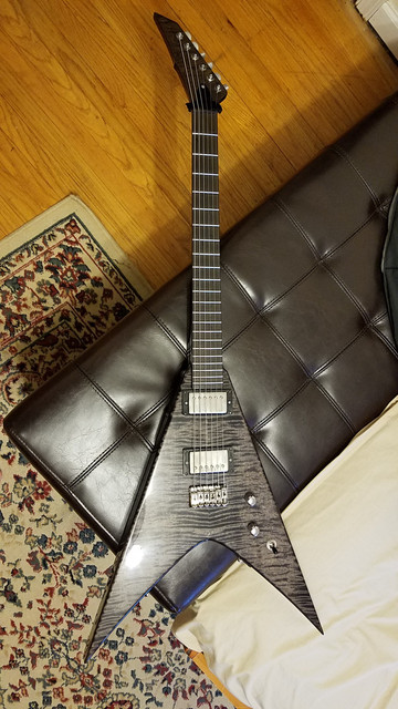

Here is a picture taken today in December with a much better camera
