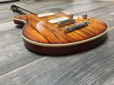

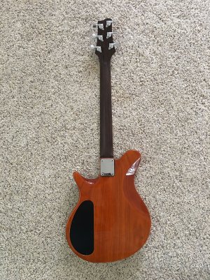

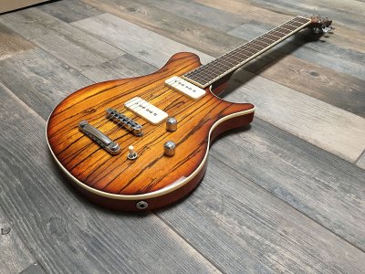

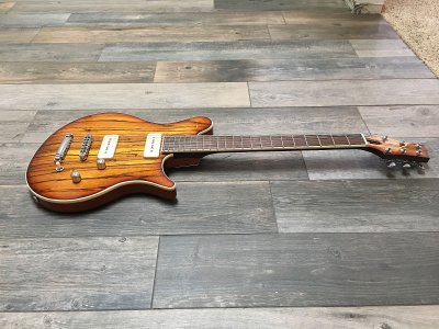

Feast your eyes on this beauty!
Here are the specs:
Body
Model: Chambered Carved Top Velocity
Orientation: Right handed
F-Holes: None
Scale: 25-1/2"
Wood: Zebrawood / Swamp Ash on Swamp Ash
Rout: Rear Rout
Pickup Rout: P90 (Neck), None (Middle), P90 (Bridge)
Controls: PRS Style
Bridge: TOM/STP, Angled Pocket
Stud Install: Use inserts from bridge on order
Jack Rout: 1/2" (13mm) Side Jack Hole
Neck Pocket: Strat® Shape
Contours: Contoured Heel / Tummy Cut
Binding: Ivoroid Binding
Top Finish: Honey Burst
Back Finish: Transparent Amber
Finish Type: Gloss Finish
Neck
Style: Warmoth
Construction: Gibson® Scale (24-3/4") Conversion Tiltback
Orientation: Right Handed
Neck Wood: Wenge
Fingerboard Wood: Wenge
Nut Width: 1-11/16"
Back Shape: Boatneck
Fret Size: SS6105 (Stainless)
Tuner Ream: Schaller (25/64")
Radius: 10-16" Compound
Scale: 24-3/4" Conversion
Fret #: 22
Pre-Cut Installed String Nut: GraphTech White TUSQ XL - Standard Nut
Inlays: Cream Face Dots
Side Dots: White Side Dots
Binding: Ivoroid
Hardware
Bridge: Tune-o-Matic Bridge and Stoptail
Pickups: Seymour Duncan P90 Antiquities
Tuners: Schaller M6 Mini Locking Tuners
Knobs: Chrome Round Top Knobs
Oh, and this being my first full wenge neck, I can honestly say I'll never own another neck that isn't wenge. This has to be the smoothest wood I've ever played. My hands just glide up and down it easily.
