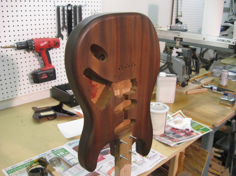

Mahogany is one of those woods that changes color quite a bit when finished. For instance, here's a shot of some raw Mahogany with just a wipe of clear naphtha on it...
And here's a shot of a Mahogany body where I pulled the tannins up with some potasium dichromate...
No finish on there yet, but there's been some chemical reaction to the PD. Then, a clear-to-brown burst...
It's not as bad as it looks - the camera's "auto" aperature/shutter compensation was getting fooled by the very bright background, so the body is underexposed and looks darker than it is. Regardless, I did get a little too ambitious with the brown around the edges. Once you put a standard Strat pickguard on it, there's little evidence of a burst left. I don't have a shot of that.
Anyway, the point of all this is to show how much Mahogany can change without any tint/dye/pigment at all.

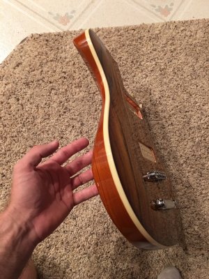

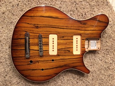

I finished shielding it today and installing the bridge. I need to get some springs for the P90 soap bars tomorrow so then I can install them and the wiring harness. Pretty much all I am waiting on now is my custom neck to be finished!

I've had good luck cutting out the appropriate shape from the packing foam the pickups usually come in, rather than using springs for P90's.  YMMV.
Oh wow... I totally did not realize that was even an option. Now that I think about it though, that's brilliant.
When using the foam, do you find the pickup backs off (and rises up) when you start to unscrew it?
That was my thought for the springs, but if you think the foam will have the same effect, I'll just go that route.
PumpinIron said:
As long as the foam has some spring to it, it should be fine - and way easier to mount than with springs.
I'll try the foam then. It has plenty of spring. The springs would have indeed been harder to mount.
Beautiful! One of the nicest zebrawood tops I've seen. Looks great with some hardware.
