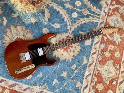

This is my baritone build with a roasted swamp ash body finished in Tru Oil:
WHOAH!!!!!!!!!! That is sick!!!!!!!! Thanks for the heads up! Was debating on non roasted, durability-wise, is it really that different? Hipshots look awesome!

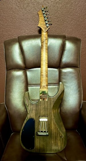

View attachment 66421that is so awesome!!!!!!!!!!!!!!!!!
