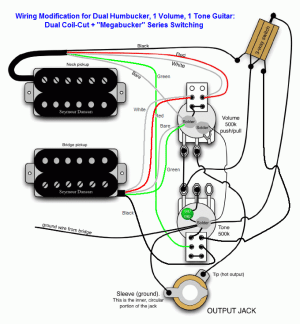

I was going to do dual humbuckers. Was thinking seymour duncans SH4 Jb in the bridge or a Brobucker in the bridge and SH2 jazz in the neck. Going to do one volume, one tone and a three way. Maybe do push pull pots so I can split the coils with one and do a megabucker on the other.

Check out this diagram. It may get you where you want to go without needing push-pull pots.
North coils:http://www.guitarelectronics.com/product/WD2HH5L10_01/Guitar-Wiring-Diagram-2-Humbuckers5-Way-Lever-Switch1-Volume.html
South coils: http://www.guitarelectronics.com/product/WD2HH5L11_00/Guitar-Wiring-Diagram-2-Humbuckers5-Way-Lever-Switch1-Volume1-Tone.html

I like this option. It didn't occur to my that you could coil split with a 5 way switch. I like that! I already have parts coming to wire it with push pull pots. I am going to keep this other schematic tucked away though. I like that you get to choose what coil you are turning on and off! I would only have to get a 5 way switch. Thanks!
