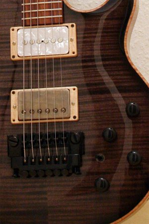

i would like to present you the finished "Thoene Black Special Custom" guitar!  :headbang:
It got finished this weekend finally, and it turned out to be one awesome sounding beauty of a rock guitar!
the nailbomb humbucker in the bridge got a 3-way switch (serial - singlecoil (neck coil) - parallel) and the tone-pot for the Z-90 in the neck got a push-push switch activated mid-filter ( off-position: normal tone-pot (high-cut) :: on-position: mid-cut )
with this thing, i can seamlessly blend the neck-pickup from a mighty Z-90 sound (punchy, loud and very defined) to a much more glassy, clear strat-pickup sound!
amazing..  :eek:
the earvana-nut is also great! everything sounds in tune now, with or without open strings, open chords, barre-chords, really cool!
i only need to cut it a little deeper for the low strings, as they tend to slip out of it during "heavy riffing".. ;-)=

oh, btw, it got some nice flamed maple pickup rings in the end, as i could'nt settle for any of those plastic ones..

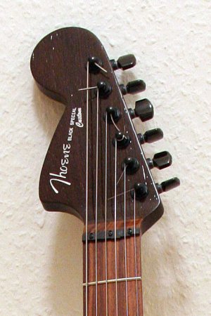

notice my "very unique" spaghetti-type logo...  :icon_biggrin:

Very nice shagga. The pickup rings are a neat match for the binding..cool! And the logo?Well I think I might have tasted that brand of spaghetti somewhere before  :toothy12: :toothy12: :toothy12:
Great!  :headbang:
How you made that white printed logo?
Does it need some finish to fix it?
Thanks.
Ventolino

ventolino said:
Great!  :headbang:
Thanks.
Ventolino
it is a silver printed logo btw, and i got this one made by one fabulous english guy name mike from the decal shop:
http://www.thedecalshop.co.uk/
it is a waterslide decal, needs to be applied wet to the raw wood, then dry for at least 24 hours, and then laquered over many times to securely fix it and make it "blend in" with the headstock!
