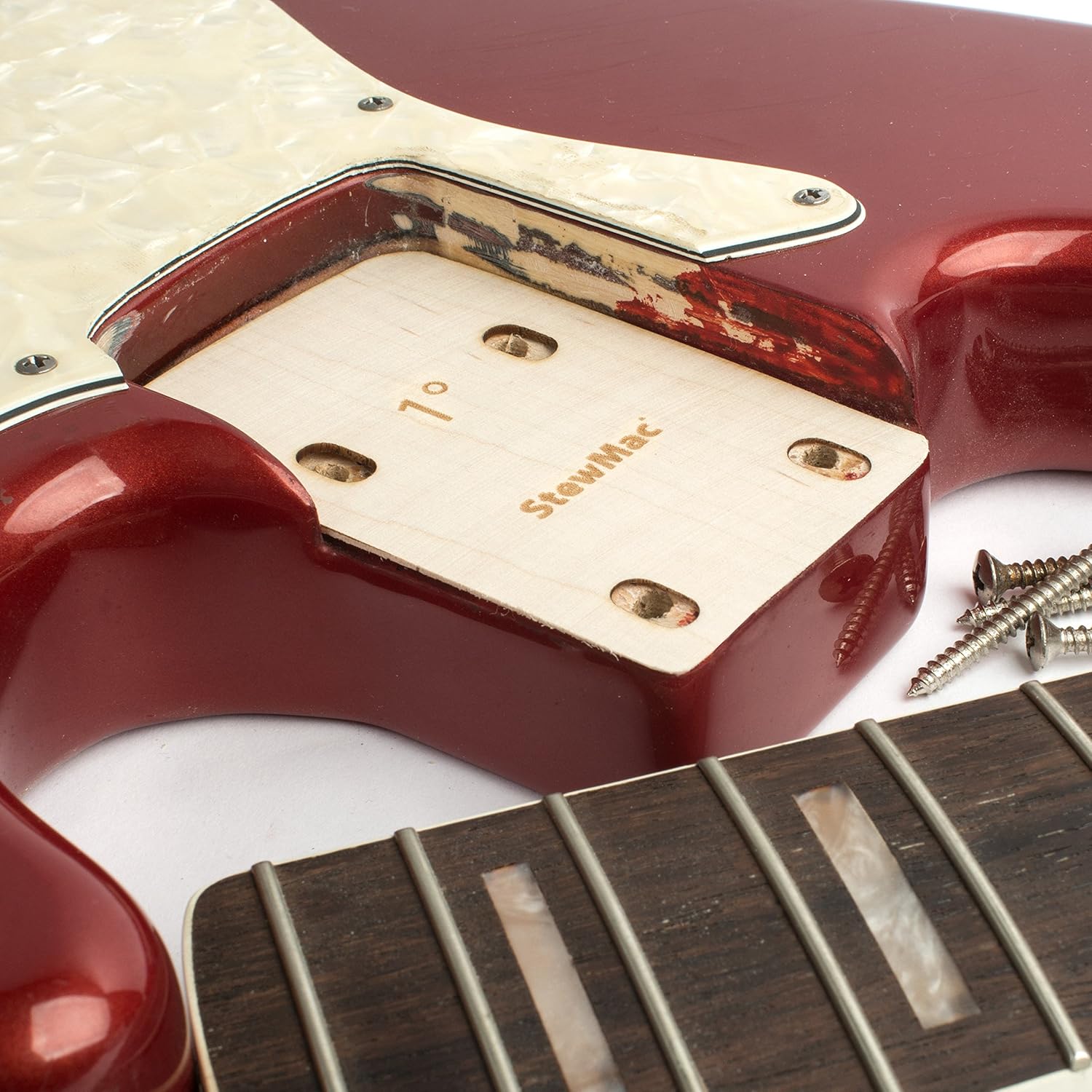

As for the shim, I highly recommend the StewMac variety. Not cheap, but when only the best will do.....
Thank you, guys.  Yes, I'm probably needing the stewmac shims.  And I will let you guys know how the mustang strings work out.
They're (the stewmac shims) a good way to go. Fills in the entire floor so there's no distortion of the heel when torqued down (which can affect upper fret leveling), and a good connection of the neck to the body so you don't get any tone-sucking from a soft neck joint.
But it looks like they are all made to shim the opposite end of the pocket?  I need to increase the action height, not decrease it.
turn it around. :icon_thumright:
Sorry...I am not being a smart a$$.  But it should work and give you all the benefits Cagey described.  You will just drill thru the plate and make new holes.
Flipping won't work.  They're asymetrical for the bass. Fortunately, they make blanks, so you can orient as needed, drill/shape to suit, and life will once again be good. And fair! :laughing7:
Edit: They're kinda pricey, but it may be worth buying two smaller ones rather than one bigger one. First, it usually takes less shim than you think to get the angle you want. Second, if neither one is enough, both together may well be. Shipping is the same, so... what's the worst that could happen? The dreaded Drawer of Misfit Parts gets a new friend who'll come in handy some day.

Well, I just ordered a set of these, .25, .5, and 1 degree increments.  Should get me where I need to be.
Almost forgot to post an update.
It's not the cleanest shim job, but it worked, does the trick, and presents a solid surface all around.  I ended up just using the 1 degree shim.  I probably could have dialed it up to 1.25 degrees.  I might play with that a bit more later.  (No pics as yet.)
