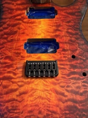

Thanks, I'll check those out. I was really wanting P90's but couldn't pass up this body at the showcase price, so I was thinking of the Duncan P-Rails and maybe the triple shots to go with them.If you need a good set of pickups, I cant recommend Red Rocks pickups out of Michigan enough.
He does a 59 set that is great and does a 59+ bridge if you want a little more umph. They arent metal but for anything from clean to rock they are awesome.
My favorite set is to do a 59+ bridge and a 59 Neck with an Alnico 3 magnet which reduces the low end making the neck pickup really cut through. Plus they are about 40% less cost than Duncans or DiMarzio

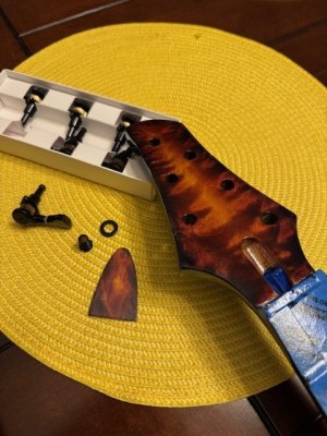

Alder, with Super High Grade Quilt Lam Top. Neck is Mahogany and Ebony. That's why I had to go with the tinted nitro for the back and neck so they would match. I definitely prefer using the custom builder but these pre-announcement showcase deals that Aaron let us in on were to good to pass up......what is the core wood on this build?
I have P-rails in an alder guitar with a maple/rosewood neck. I think they are a little darker than I prefer but with 3 control holes, I would probably do a bass contour and a master volume/tone. Also the triple shot rings can be finicky so I swapped mine out for a pair of push/pullsAlder, with Super High Grade Quilt Lam Top. Neck is Mahogany and Ebony. That's why I had to go with the tinted nitro for the back and neck so they would match. I definitely prefer using the custom builder but these pre-announcement showcase deals that Aaron let us in on were to good to pass up.....
I just have them setup so that its both down for series, pull tone for P90, pull volume for rails, and pull both for parallel.Thanks for that info ! How do you have the push pulls set up, to split both pickups or any out of phase stuff ?
