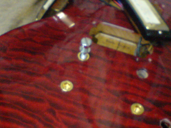

1.  Place one 'unwanted' bolt that fits the stud.  I have been changing my friend's Epiphone 335 bridge, so I use that and screw it down half way. Notice the chrome hardware.

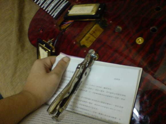

2. Clamp the screw like this.
3. Find yourself a book.  In my case is a boring chinese novel.  This is better than newspaper because you can adjust the thickness and doesn't have to fold it.  Slip it under the clamp. Tighter equal better.
4. Slowly push the clamp with a steady force. Much easier than I thought!
Now I can ground my guitar like it should be done.  Again, thank you, all of you rockers for some great tips!!!  :rock-on:
