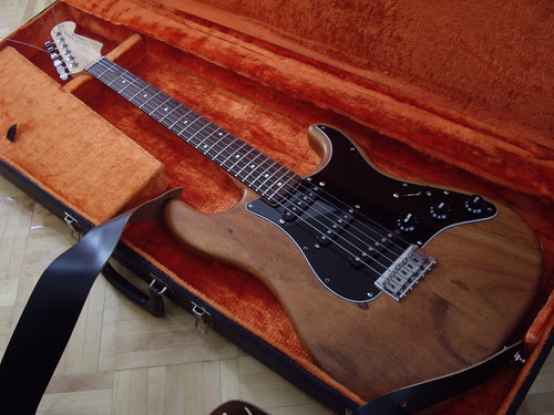

i have  akoa strat that i did in tung and teak oil. it's super resonant!
and tru-oil is great too....
but a a lacquer finish looks best on koa, i think. especially if you have a really nice piece of wood!
