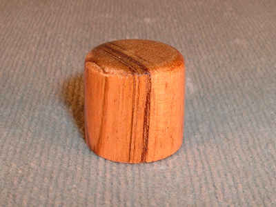

I have 4 knobs ordered from some ebay fellow that are made from Goncalo Alves, I figure it'd be pretty cool to have them match the neck.  ( http://cgi.ebay.com/GONCALO-ALVES-WOOD-GUITAR-BASS-3-4-KNOBS-6mm-SATIN_W0QQitemZ370118654819QQcmdZViewItemQQptZGuitar_Accessories?_trksid=p3286.m20.l1116 )
