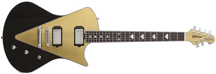

Well, at least yours is gonna be real. Music Man makes very nice guitars for sure, but when I saw this, my first thought was "they figured out a way to use up the triangular scrap leftovers from the "BFR" guitars!"It's a maple "cap" that uses 1/3 as much (expensive) flame or quilt maple.
First time I saw one of those, my first thought was "I'm sure I've seen an uglier guitar, but I can't remember when..."

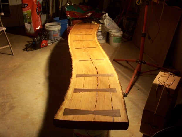

I didn't know he had a few other things in mind to strengthen the seam. Today he showed me 'bow tie keys'. So I believe monday, that is what I'll be doing. I also believe I'm going to be routing the channel for the inlay that I made. So, now hopefully you guys can envision what I have going through my head for the final goal.
