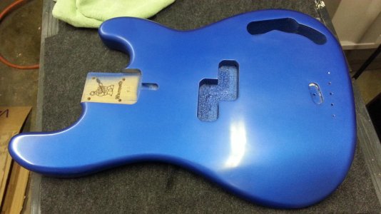

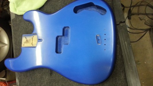

So here it is (pics below). I didn't want to post about it until it was mostly done, because the damn thing has been cursed so far. It doesn't look bad, but I know where the bad spots are, so they stand out to me. I'll shine it up some more, and build it out and then decide if I'm gonna keep it, or find some kid at the local music school who can't afford a good bass and just give it to him.
Once I shine it up some more I'll take some pictures in the sun so you can see the metal flake better.

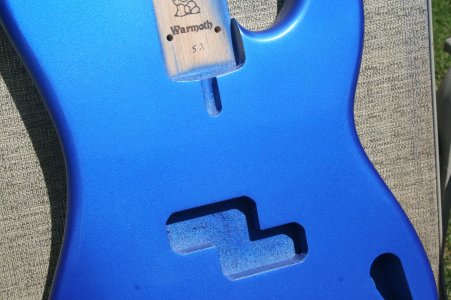

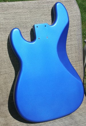

Here are some pictures in the sun with a slightly better camera than a phone.
wow!  That looks great.  It's going to look even better with a pickguard on it...
Thanks, all.
My problem is, that when I build things, I'm a bit OCD. So once I know where I made mistakes, I can't stop looking at them. Yeah, it looks good, but it could have looked oh so much better.
Hoping to move to a new place in a few months. Once there, I'm going to see about a better place to paint than just the garage and I think I might start going with a urethane clear coat that's a bit tougher than the water based ones. I'm starting to think that some of my problems are because I'm using a consumer grade water base clear and I need to move to something a bit more robust than that.

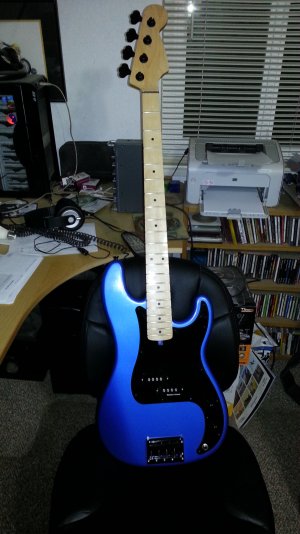

Well, except for the strings, it's done. Finished it just a little while ago. Sadly I forget to get strings for it, and the store I like to go to is closed until Tuesday. So either Guitar -ugh- center, or maybe order a set online.
Here's a pic:
Looks killer. Now let's crank up some Iron Maiden* and RAWK :headbanging:
*Didn't Steve Harris use a blue P-bass?
