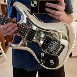

Ibanez has finally gotten their "chromeboy" JS models into regular production, albeit in pretty limited numbers, over the past 6 years or so. The finish seems to be durable, unlike some of the earlier attempts they'd made. Rich Harris, at Ibanez Rules, is convinced that they're using the Alsa "easy chrome" paint and then a softer paint protective finish that's self-healing (his notes on this are here). After craving a chromeboy for many years, I finally pulled the trigger this month and am completely in love with this guitar. This pic into a mirror captured the guitar reflected within itself a couple of times:
Any chance Warmoth would consider doing a special run of chrome bodies? I'm guessing the market is small, and that Alsa paint is pretty pricey, but I also think that small market would be willing to pay for Warmoth quality and uniqueness. I'd want a strat and/or soloist body like this!

Is it a left-handed model, or is it a mirror image in the photo?

Thanks, that’s mirror image. They don’t offer this as a lefty.
