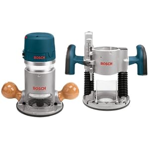

That's a good one. Something I didn't realize when I bought my plunge router. In other words: It doesn't accept 1/2'' shanks which sucks because now I can't use 2'' template bits. Chances are I'll be buying another router if I ever build another body.
When you get ready for another router, look hard at the Bosch units. Of the three different routers I've owned, that's the best by far. They're strong, the accuracy and repeatability is excellent, and they they have a wide variety of accessories for them. Not the least expensive units out there, but you definitely get a lot of tool for the money and you don't have to worry about it. I highly recommended the the 1617EVSPK package.
Soft start, speed control, both collets, both bases, template adapter, case, etc.
Normally $426, Amazon has a helluva deal on them for $197 w/ free shipping.
