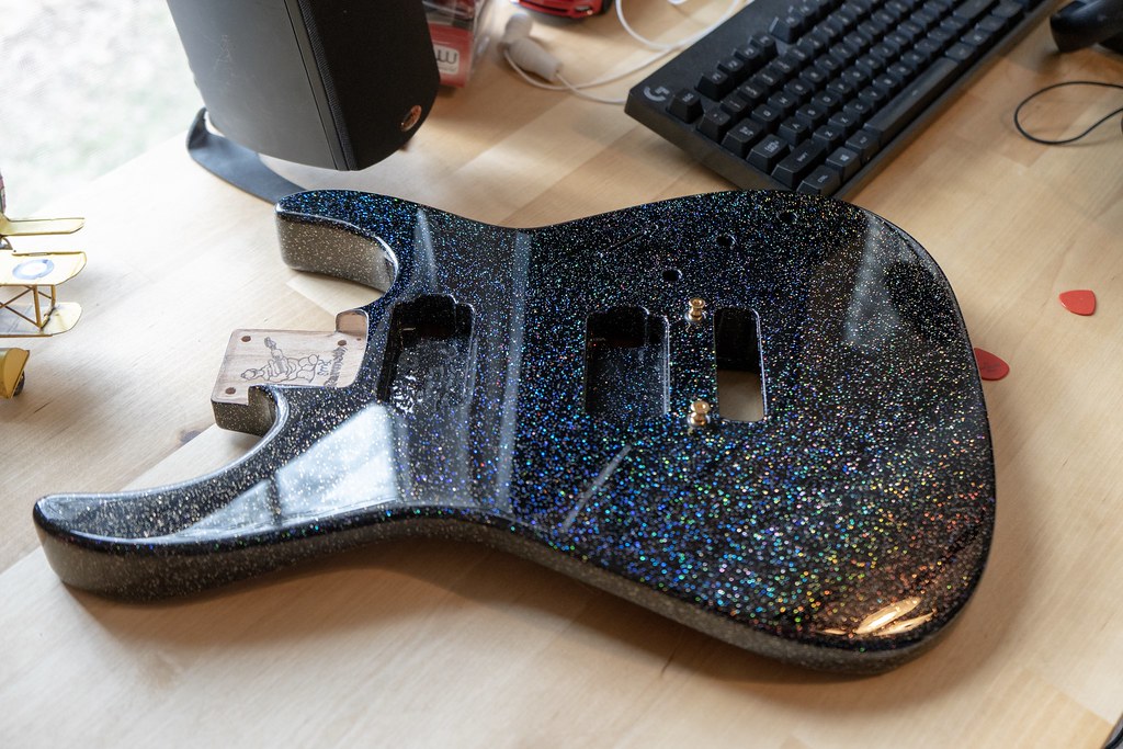

Got the body and neck in yesterday at 8:30am! I was at work and left after lunch to WFH so I could ogle the parts haha.
I have to say the pictures and videos of holoflake do it no justice. it's super cool in person. It's also much better than Fender's CS holo flake strats. I saw two old CS holo flake strats shortly after ordering this and it made me immediately worry it wouldn't look good. Fender's holo flake looks more like "Christmas Flake" and the two that were hanging in the shop were very sparsely flaked.
Unfortunately it's been raining or overcast yesterday afternoon through this weekend, so no really good pics of just how well the flake pops. It's really cool. Both more subtle yet more flashy in person.
Shortly after tapping in the Floyd studs with a deadblow:
