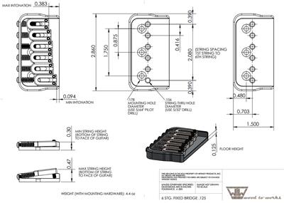

Here are the specs for the Hipshot linked in your first post:
And for the Warmoth fixed bridge options:
https://www.warmoth.com/Guitar/Bodies/Options/BridgeRoutingOptions.aspx
The mounting holes are .875" on the Hipshot, .890" on the Vintage Strat Flat Mount and .827" on the American Standard Strat.
The string hole spacing is .416" for the Hipshot, .446" for the Vintage, and .413" for the American.
So, from these specs, the Vintage mounting holes are closest (+.015") and the American string hole spacing is almost identical (-.003").  I suspect the screw mounting holes for the Vintage are close enough to be used without issue and, as I mentioned in my earlier post, though the Vintage string holes aren't right on, they will work fine, so if it were me and I didn't want to drill the mounting holes, I'd go with the Vintage 'route'.

Thanks for that, Yah  I was going back and forth myself between the warmoth routes and the hipshots and nothing was fitting perfectly. I didn't know whether or not measurements needed to match exactly. I would honestly prefer the shorter string spacing in the american, but it looks like you're saying the vintage would probably hold up better?
There also another style hardtail from hipshot and one for sale right now on stewmac for cheaper than hipshots price (it might be the same as the one I originally posted). Ill try and attach the diagrams.
Do any of these match more closely?

It depends if you want to drill the mounting holes yourself.  If you don't want to drill, the Vintage would probably work best as the mounting holes are very close to the Hipshot 41065 (from the first post and StewMac).  If you are OK with drilling the 3 mounting holes, the American route would be better as the string hole spacing is nearly identical to the narrower Hipshot.

The 41200V is identical in specs to the Warmoth Vintage route so it would certainly work and be the easiest to deal with as far as compatibility.  The 41200M mounting holes are different from Warmoth so you'd be in the same boat as with the 41065.
