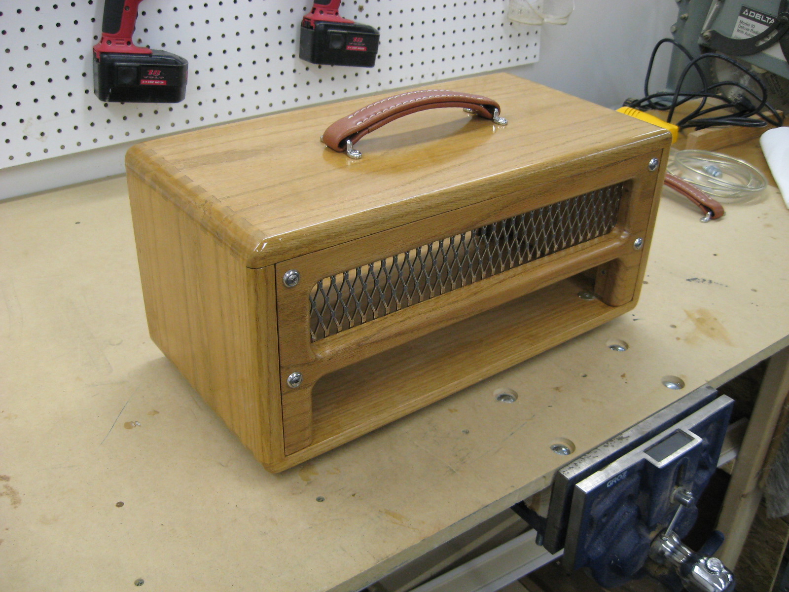

Sure, but they're not good shots, and I think front bezel was just dry-fitted because you shouldn't be able to see the beading on the left, as it was recessed. Also, you can't see the best feature, which was the dovetailed joinery.
Front view
Rear view
The front is Zebrawood, the rear is Red Oak. There's another one that's all Red Oak, but with a Zebrawood front. They're both heavy little rascals, but they're just heads so it's not that big a deal.
Here's a rear shot of the oak version that shows up the dovetailing a little better...
Fine craftsmanship, Cagey!  :icon_thumright:
