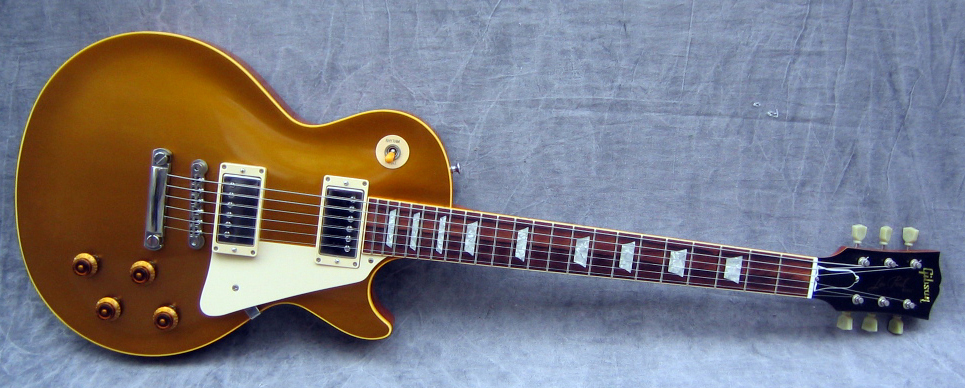

is it just me, or does the warmoth goldtop gold paint look nithing like the gibson goldtop paint?
warmoth "goldtop gold"    http://www.warmoth.com/paint/paint.cfm?fuseaction-metallic_goldtopgold
gibson goltop (the real thing)
tell you the truth, warmoth's candy yellow bears a better resemblence....http://www.warmoth.com/paint/paint.cfm?fuseaction-candy_yellow
just noticing. maybe they should rename the colors, or maybe each paintjob is so unique that the sample picture looks nothing like the real guitar. I dunno, just making an observation.

For that future project I'll be spraying the top with ReRanch Gibson Gold Top repro paint, so it would be more that shade...
I think it does look like the Gold Top colour. Maybe just me. Gibbo gold top's vary quite a bit too.

I owned a Gibby Gold top and been around a lot of them over time and it is true, they vary between each other and then again with age. Seeing the Warmoth Gold Top Gold up close, I think its about as close to average as you're going to get.
With everyone looking at a different monitor and all the pictures taken with different cameras in different light, it's pretty hard to see accurate hue differences. Usually though, I could comment on the Warmoth Gold Top Gold being a tad too green or yellow, but I think they got it in the zone, at least from my own experience.

Yeah, the color that I think most people associate with Gibson Goldtop is from the late '50s; those were nitro finishes and have aged/changed over time, didn't look exactly that color when new; now the typical application is using color to recreate the aged, rather than original color.
