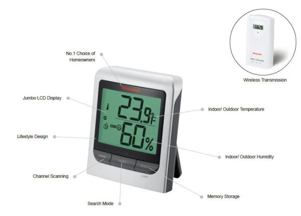

Both factors are important. Usually, if you want a higher-quality finish in a home environment, you wanna shoot lacquer. With that, the rule of thumb is what they call the "rule of 65". Don't shoot if the temperature is lower than 65 degrees F and/or the relative humidity is above 65%. Those are "do not exceed" levels; actually you would like the temp higher and humidity lower. You can cheat that a bit with chemistry - more or less reducer and/or more or less retarder, but the rule is a red line that'll keep you from even considering a day's worth of toxic fume inhalation.
I keep a Honeywell widget similar to this out in the garage to guide my decisions...
They run about $40 or so, but it beats the snot out of having to strip and re-do a finish. When you consider what it would cost to have a professional finish applied, it's a small price to pay. Although, I've said it before and I'll say it again - Warmoth finishes are a bargain. Unless there's a color or style they just won't do, it's foolish to do it yourself. I know it seems like a lotta money on the going-in side, but you can't really do it yourself for less. The amount of labor involved is too much, and you're not going to shoot catalyzed poly, which is a wicked hard finish. Plus, it's their ass. If Mr. Warmoth Painter Guy is having a bad day and sags/runs the thing, they're liable to just toss the body because stripping and refinishing is a nightmare from hell they can't afford if they want to stay in business. If you do it, all you can do is cuss up a storm and start over. No fun.
Thanks Cagey, always appreciate the sound advice. I would more than love to spray a lacquer finish on this, but I'm unable to because I live in an apartment. So, I'll be staining and then go in my storage closet and spray some sanding sealer then wiping on the lacquer. I could go to an auto body shop and have them spray it but money is tight so I'll do what I'm able to.
