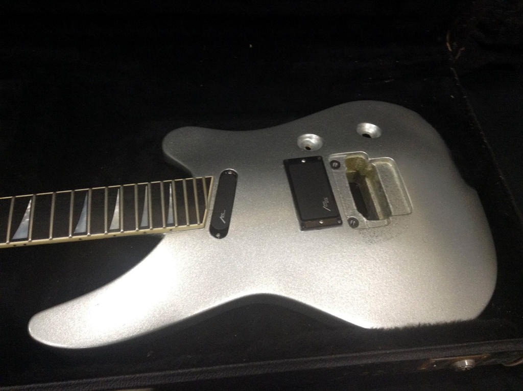

Hopefully, this will turn out fine for you, but here is my tale of woe regarding craft-style glitter paint.
I bought a Jackson Phil Collen Archtop that had a glitter silver paint job, original factory paint.  Normally, actual glitter — the stuff that kids glue on construction paper for Valentine's Day — is what's used in glitter paint jobs on guitars.  Jackson paint, however, decided to go the craft glitter paint route.  Their method went like this:
- Wood Sealer
- White Primer
- Satin Silver base coat
- Glitter Paint
- Poly Clear Coat

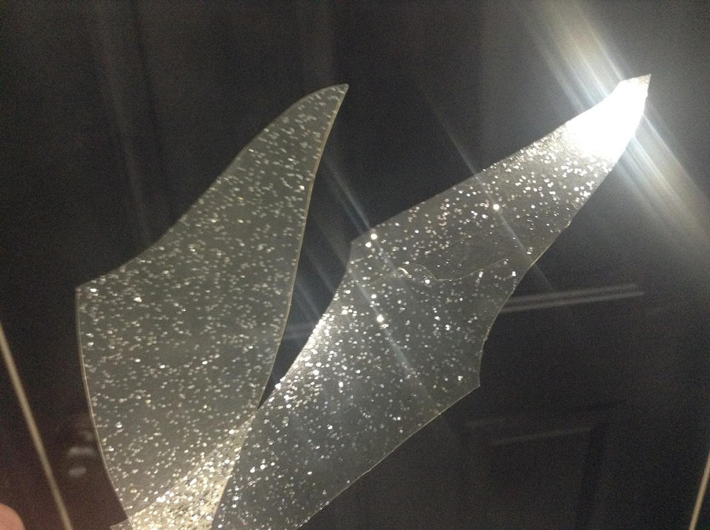

Jackson is famous for doing too-thick clear coats to begin with, which often turn yellow.  This one was so thick, it came off like shards of glass.  Came off?  Yes.  You see, the glitter paint didn't really adhere to the silver base coat and over time separated.  A crack in the clear coat turned into a peel, which turned into shards of paint sliding off the guitar.
... and now it looks like this:
(you can still see some of the yellowed clear coat in the trem cavity)
