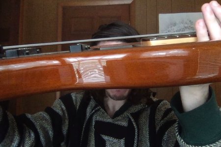

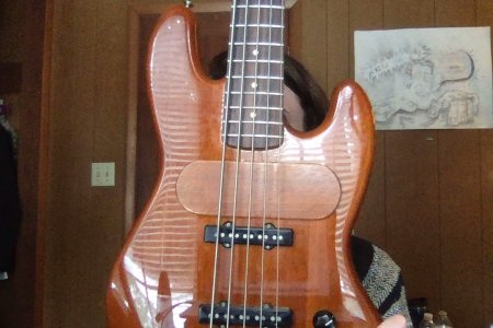

So it's a bit hard for me to explain without directly showing you or making a video about it. The thickness is uniform. It is just a pick guard, but with a different purpose for slap bass. Basically, the ramp places your fingers at exactly the level you want them for a perfect pop. You can't go any lower. So you can remove a lot of tension while playing, just let your fingers drop. Without any ramp, your fingers have a lot of space to completely slide under all the strings, and you need to change your technique and apply more tension in your fingers to keep them on the appropriate height.
I hope that makes sense. I'm already using a custom slap ramp on my current jazz bass which is slightly higher than a standard fender bass pick guard. Hoping to match it exactly in my new bass

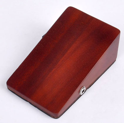

Interesting. Never heard of such a thing, but then I'm not a bass player. The way you describe it makes sense to me. I wonder how long it'll be (if it hasn't happened already) before somebody puts a piezo sensor underneath it so you can do a bit of "percussion" along with your playing, sorta like these things...
That particular unit is designed to replicate a bass drum you can keep time with using your foot. All it does is let you thump it, and it turns that into something an amp can make bigger. Must be super simple - they cost very little.

Also - for future reference for anyone else seeking the answer to this question - A Warmoth rep got back to me and said he personally measured a bass in their shop. The distance from the face of the body to the face of the fretboard is about 0.4 inches, obviously with other factors affecting that such as finish.
Personally I think 0.4" is quite a lot and may not be fully accurate. My fender jazz bass is about half that distance. I'll probably just wait until I actually get the bass in the mail and then order the wood for the slap ramp. I'll probably also order wenge so I don't need to finish it (and it will match the neck of the bass).
This is the site I'm ordering wood from (they have EXACTLY the options I need for this specific build, check them out, would be useful for any custom pick guards or whatever) http://ocoochhardwoods.com/scroll-saw-lumber/
A standard Fender spec neck is 1" thick and the pocket is 5/8" deep. That leaves 3/8" ~ 0.375" (plus the frets of course). I don't think Warmoth offers their 0.720" mod on basses, but it might be worth asking them.
Yes, interesting. I was going by my Mexican fender deluxe series 5 string jazz bass (shown in the pic). I also have an older 4 string Mexican fender jazz bass (which clearly has a superior build quality over my 5) and the height on that one is closer to the figure Warmoth gave me.
I should probably just trust the 0.4" figure, as a Warmoth rep for sure has a much more accurate way of measuring than I do (I'm using a freakin' yard stick atm, need to get a ruler haha)
