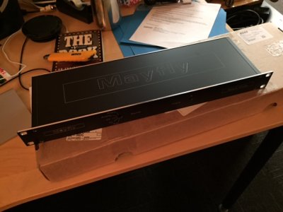

As many of you know, I like to build stuff.  I'm especially a fan of building electronics for music.  Some times kits, sometimes my own design, some times point to point, sometimes PCB.  But I always end up with the same problem - the finished product ends up looking like crap.  I'm not great at wood working, marginal at metal working, and let's not bring up tolex or other upholstery stuff.
But I think I found a solution.  I recently designed/built a preamp for my stereo, which is constantly evolving.  But as usual the metalwork looked like crap and I had no way of clearly labeling the thing.  Then I found Front Panel Express:
http://www.frontpanelexpress.com/?gclid=CMfvv7-kpMgCFQiOaQodciwGfg

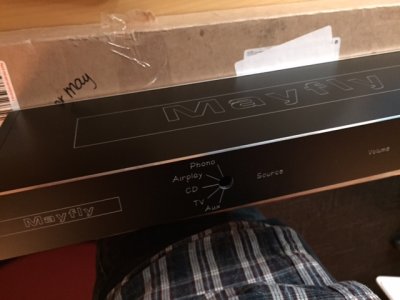

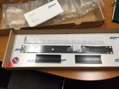

I thought "what the hell".  So I designed a 1RU box for the preamp.  the bits arrived today.  They came extremely well packed and the quality is very high.  I like it!  Attached are some shots.
So if you find yourself in this sort of situation, give them a try.

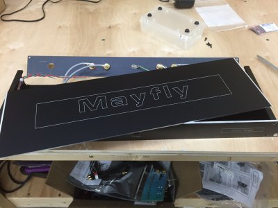

That looks very good, and professional as well. Is that engraved or silkscreened or what?

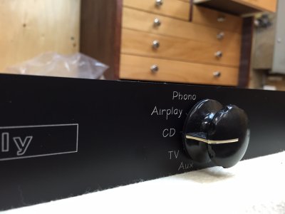

I have mine engraved. And you can choose fill colors.
Yepper - it's engraved.  I chose 'silver' for my fill colour  :glasses9:
They even have a free CAD-lite builder piece of software that lets you design the panel using spec spacings, so it is exact.  Then it will price it for you based on all the options you pick.

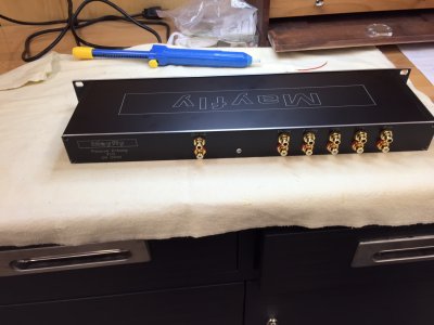

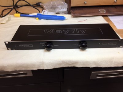

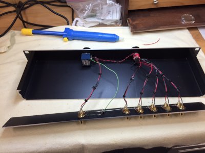

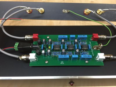

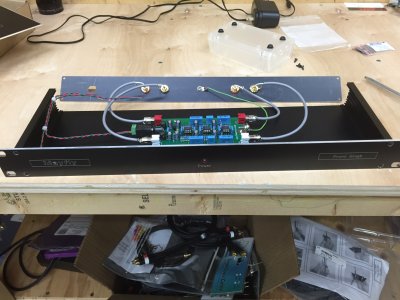

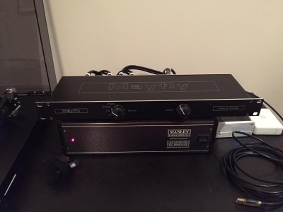

All done.  Went together without issues.  10k Alps pot with a gold contact Grayhill switch.  Gold RCA jacks and a little time with a soldering iron.
Sounds very, er, transparent.  :)

Looks good, simple and classy. I like passive preamps for their no frills sound, even cheap ones do not color the sound as much as actives.
I like that you put phono first, that's always how I think sources should be in a amp as not only I prefer vinyl but I have more records than tapes and CD's together. BTW, I know there are all line sources but why you named the second input Airplay?
Mayfly said:
...I recently designed/built a preamp for my stereo, which is constantly evolving...
What is the rest of the system? The Manley phono looks old, it doesn't have their current look. I've always liked Manley products, both aesthetically and sonically but there are out of my price range.
The Manley is indeed an old one.  It's from their original line of products - long out of production.  Sounds great mind you.  I bought it directly from EveAnna herself when I bought an original "gold front" Manley stingray.  The stingray is gone, but the phono pre remains.  I have several phono pres, including one I made.  This one is the best.
The turntable is a Rega planar III with a middle of the road ortofon cartridge.  Old school and reliable!
CD player is a Harman/Kardon. nothing spectacular there.
Airplay is just that  - apple airplay through a good quality DAC via the optical output.  Yep, I listen to stuff using my iPhone AND a turntable.  So there  :icon_biggrin:
The speakers are a pair of linkwitz plutos.  They are freaking spectacular.  They are the reason why the stingray got sold.  I've posted about the plutos before - I'll dig up the link for them.

For this one I used FPS's standoff option to place standoffs exactly where they are required for the PCB.  It worked out very well.  They also cut a perfect D hole for the power input jack.  I've never had metalwork this nice for a home project!
BTW, the phono pre is a bugle2 by hagerman:  http://hagerman-audio-labs.myshopify.com/collections/phono-preamps/products/bugle2
Turns out that I used 1.3K resistors instead of 13K in one critical spot in the preamp EQ.  That made it sound very, er, funny.  I didn't have 13K resistors so I made them up out of some 12K and 1K in series (see the right hand side of the PCB).
