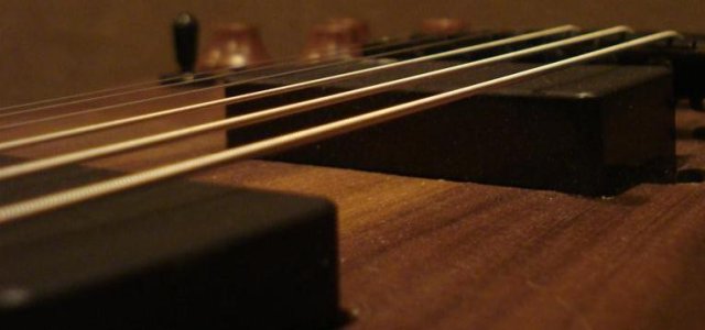

Schedules lined up this weekend so my friend and I continued work on the build. Most of the routing and drilling is done except the channel for the pickup wires. Routed the control cavity as well as one for a battery box in the back. Due to a planning error on my part the body is not quite as long as a normal SG - guess it is now a  "short tail sg" or something. When i first noticed this i was quite worried about it but after more work and getting the pickup routes in it didn't seem as bad. Getting excited as the build could be done within two weeks and i could be playing this thing.

the build is DONE!  :icon_biggrin:
the SG turned out very awesome. the Warmoth neck plays like a dream. chords, bends, it just really wails.
i still can't believe it's done - and it was quite an experience working with my friend to make this happen. watching a guitar come together is a lot cooler than strolling into a store and buying one.
attached the best pics i've got.
