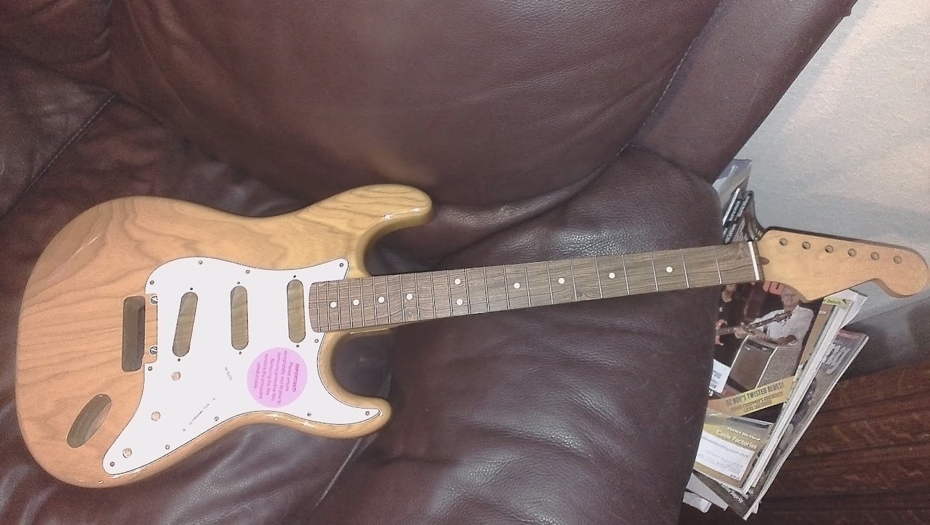

Mine straight out of the box. Just the body, neck and pickguard. It's hard to see but I really love the grain on the bocote fingerboard.
