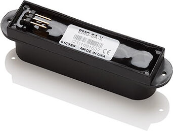

Hmm. I only have one SSS routed Strat body, and I realised I can't compare, because it has EMGs in it. As you can see from this image, the wire comes off of an EMG parallel to the length of the pickup:
So it naturally finds its way through the tight holes.
