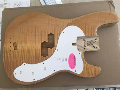

Well the body arrived! Warmoth did and amazing job on it. This bass will look killer once done. The body is flame maple on swamp ash. Here are a couple of pics with and without the pickguard. With the white pickguard and the black hardware I got...including the pickguard screws, this should look great! The photos really don't do the flame maple justice (plus I was in my kitchen!)
That’s a beautiful body. Almost a shame to cover such a big part of it with a pickguard.
I hear ya. My goal is to have a slick modern looking bass with an old school flare to it. Kind of best of both worlds

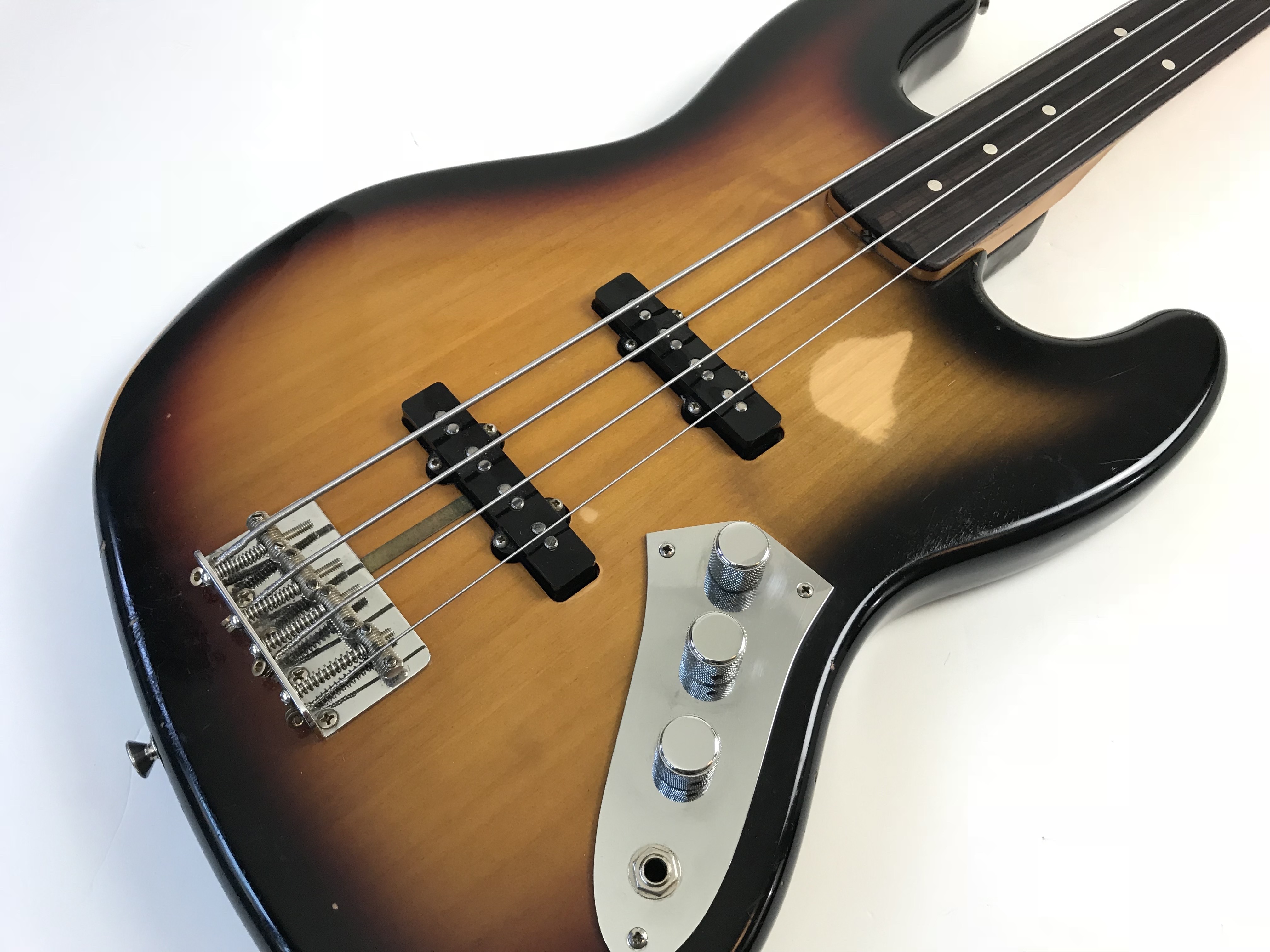

Or do like Sting and Jaco and only use a control plate? Just a thought. :icon_jokercolor:

Interesting, but I actually like the look of the ‘72 p-bass pickguard. The neck will sport a Telecaster headstock, thus that old school look.
I think once you see it with all the black hardware including the Hipshot Kickass bridge you’ll agree.
