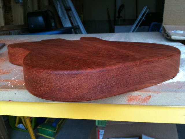

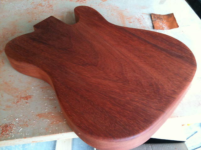

mgaut051 said:Padouk mockup.
No time to plane \ laminate etc the cocobolo for now.
So one piece padouk mockup it is.

mgaut051 said:ihavenothingprofoundtosay said:(...)
Seriously, that's a fine instrument grade piece of wood right there!
Just from the local lumber shop. I initially wanted maple, but they didn't have a big enough board to make a one piece.
I picked padouk, but I also had the choice between walnut (I have a nice blank for a les godfrey fretless copy, so nix that), mahogany (my bass is mahogany, so nix that), purpleheart (too hard), bubinga (too heavy), and yellowheart (too yellow). And padouk is relatively cheap.

mgaut051 said:Self explanatory.
HB rout looks misaligned - it isn't.
My Vernier says +/- 0.1 mm difference max. Which is not much really.

That's gonna be a puuuuuuuuurdy tele for sure... :icon_thumright:mgaut051 said:This went rather well.
Weight is 5lbs 0oz now.
Next: control cavity and jack.
Martin

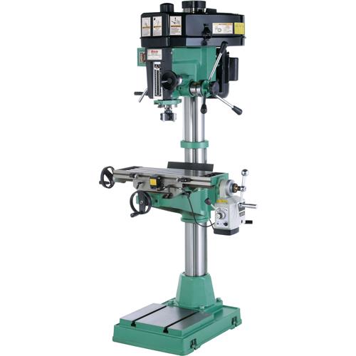

It's even upgradable to cnc, for another 2G's... :icon_biggrin:Cagey said:Here's a Drill Press w/ Cross Sliding Table & Power Feed...
$2,324 delivered. ~30% cheaper than a Les Paul Custom.
You're welcome <grin>
DangerousR6 said:It's even upgradable to cnc, for another 2G's... :icon_biggrin:
