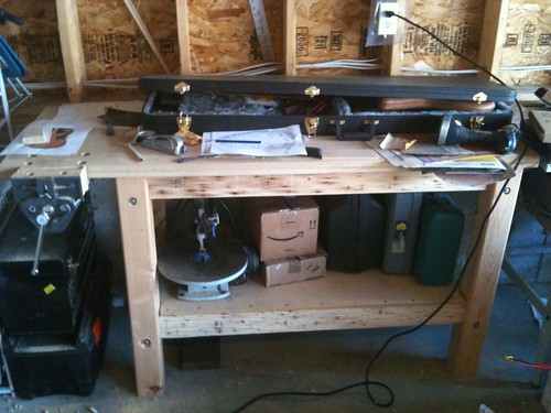

Made a workbench with MDF and 2x4's, about 200$.
got the vise for a steal (40$, NIB) and the plans are here: http://www.finewoodworking.com/item/18985/still-dont-have-a-workbench-this-one-is-easy
That's my bass-in-progress on the bench, and the image on the left is a Les Godfrey bass I'd love to copy onto a gorgeous one piece of walnut I have, for a fretless all purpleheart neck.
Got a MASSIVE drill press for 40$ - dates back to the war!
And this kit from lee valley for sanding templates square and smooth:
Got the bandsaw for $180. I feel like I robbed the guy. It's new, and the tires barely had any marks on them. Still looking for a riser kit.

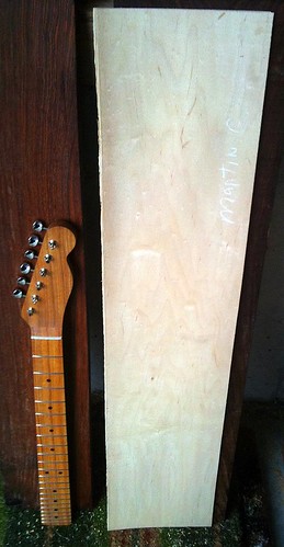

The lumber:
4/4 cocobolo, about 60$ a piece.
The reverse of the second one has more sap, but I filled it with CA, so it looks terrible ATM.
The pinstripe:
Maple from Constantine's
thick stuff!

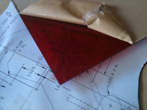

As with the control plate, I need the pick guard. But again, such nice wood. So - transparent pick guard.
Pretty sure I'll go with the transparent red
But if I feel adventurous, I got fluorescent too.
Got from TAP plastics ( http://www.tapplastics.com/shop/product.php?pid=341& ) - reasonable prices, and will cut to any size,  but got completely destroyed by customs. 30$ brokerage on a 46$ order!
Again, I'll probably mock up two different pick guards: one that's a straight 7/8ths scale, and so will bottom out just at or below the middle pickup, and one that is stretched on the string axis of the guitar, a so to clip the bridge at the same place as on a regular tele (because of the shrunken body but unchanged scale, the bridge is relatively closer to the butt end of the guitar, so if the pick guard is to need a bridge cutout, it will require to be stretched on one axis...)
