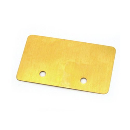

Also, I saw these jazzmaster pick shields at amazon:
Are these necessary to the JM sound? if I shield the body, would I get the same effect?
If those plates were necessary to the Jazzmaster "sound", they'd be installed in the original Jazzmasters where the "sound" originated.
Shielding a Jaguar/Jazzmaster, as it is with most single-coil pickup equipped guitars, is pretty much an exercise in futility. Won't change the sound, and won't quiet it down. But, it won't hurt anything either, so if it'll make you feel better you can do it without worry. At least it'll look better in pictures of the guts, if you're inclined to publish them. But, anyone who knows better will just smile while thinking condescending thoughts.

I went with the Fender product, though I've seen examples of folks using everything from packing foam to weather stripping.
Beware that the brass shielding plates Fender sells may not fit the Warmoth JM as the routs are shaped differently.
