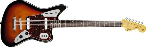

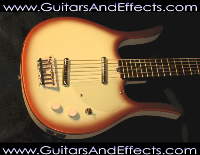

I covered this in another thread somewhere, but the Jaguar Baritone Custom (also called the Jaguar Bass VI Custom) was an updated version of the old Fender Bass VI and featured a 28.5" neck and used the same gauge bass VI strings.  It was a hard tail version; the shape was closer to a Jag/Jazz than the originals; and it only had dual single coils. A warmoth JazzMaster with baritone neck would get you a very similar look and feel to this one.  Never played one, so I don't know how flubby the low strings are.  The Jerry Jones Bass VI, is 30" scale and uses a lighter guage of string than the Fenders at 24-34-44-56-72-84. That might be more useable,but the sound won't be as thick bodied.
Super Turbo, the timbre of notes at the same pitch will depend on the string guage. If they're comparable, I expect the sound will be the same. That's the route I'll be pursuing. I think a baritone will give me many more "useable" notes than a Bass VI. I found the Schecter Hellcat VI to be pretty useless when using the bottom 3 strings. The chrous/delay is definitely a prominent feature, but the Bass VI is also a signature sound in Cure songs and quite distinctive in it's own right.
kidgloves2 , if you are having problems sourcing parts for a Bass VI build, head over to the Offset Guitar Forum. There are a number of Bass VI builds that have been covered on those boards. It's a great source of information, and they even have a parts list for that type of guitar.
Adding Jerry Jones Bass 6 pic.

The smaller scale Jaguar body will not be compatible with the 30" neck.  In fact, I don't think any body other than the USAG BassVI will be. It's a safer bet to either go for the USAG Bass VI body as well, or a Warmoth 25.5" body with a baritone conversion neck. (I'm discounting moving the bridge yourself)
The string spacing will be equal to whichever bridge you decide to use.  You may need to check on the Offset Guitar Forum as to what bridges are acceptable for intonating a Bass VI now that Atelkof Lutherie no longer makes replicas.  According to that site, some Bass VIs are built using a standard Jaguar or Mustang bridge, but you have to wind the saddle all the way back.

I found out today that the Jaguar body style for the Fender Bass VI with 30" scale neck was larger/unique. So Warmoth would have to add that to their catalog too. I really don't see why not, USACG seems to do a lot of sales with this. And I contacted them and they don't do any mods, just recreations of the original. I want Humbuckers and a stoptail. Warmoth would probably give options.

You can build a Warmoth Bass VI using a modified Jazzmaster body and 28.5" neck.
If you want a direct replica Bass VI with some modifications, then you have to go with USAG, Shamray or another custom builder like Gecko ho builds Bass VI www.wizardsofaz.com/gecko/
