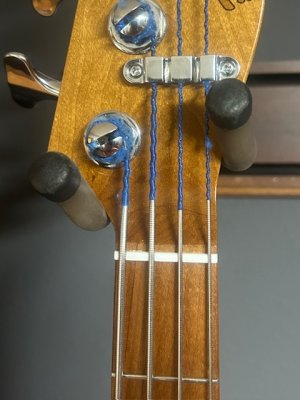

Per these SSB's, I watched videos of a guy who built one but flipped the headstock so as to expand his choices of strings. I guess that the little bit of extra length for the low E string can make a difference? What do y'all think? Necessary or no? I plan to slap on some decent flatwound strings and forget about it.
I used the short scale, medium tension La Bella Deep Talkin Flats on my SSB and called it a day too. Here’s where the wrapped parts line up on a 30” scale.
