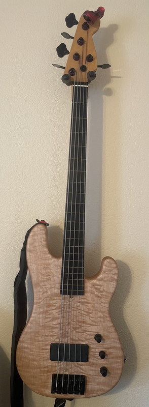

As someone who is so talentless when it comes to applying finish that I have butchered even the simplest Wipe-On Poly, I'm going to humbly suggest wax; specifically, Howard Feed-N-Wax. Won't be as impervious to scratches as a harder finish, and may require re-applying every year or two or five, but it is literally a no-brainer to apply (and I'm living proof, as I have no brain and yet this is the only finish I've ever gotten successful results from DIY-ing).
This body was just two coats of Howard Feed-N-Wax and it is effing gorgeous up close, and feels lovely:
[Edit: I just saw that OP wants a glossy finish...so, disregard. Or change your expectations.]
