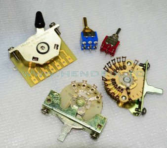

as the flat top wood in control cavity only around 4mm in thickness , any switch with screw thread lenght  longer than 7mm can work .
like this 2 kind I have use :
index.php
