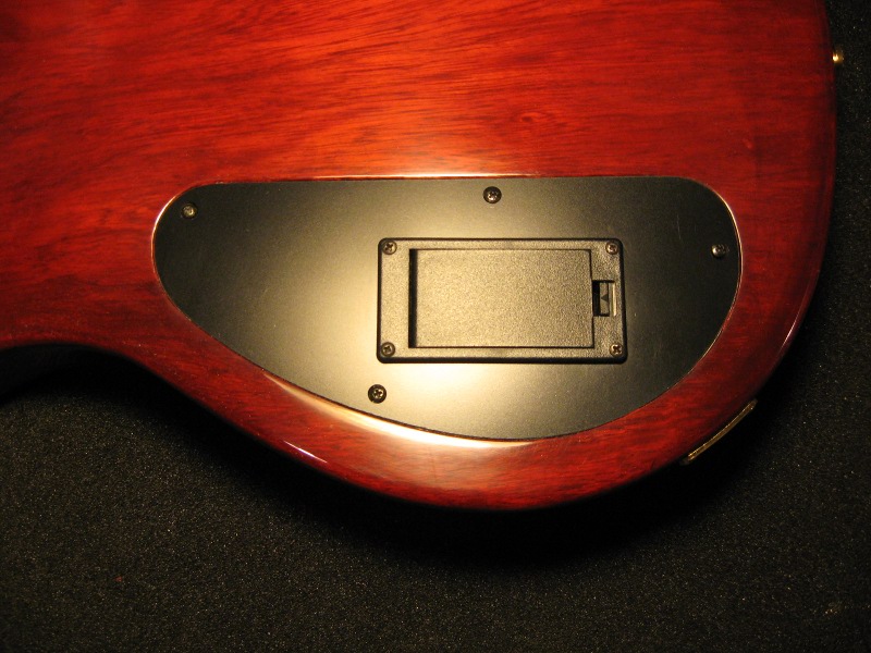

I've managed to line the cavity with copper foil and get the pickups hooked up and soldered all the electrics. Went to plan really, only got the pickups the wrong way round at first but was an easy fix. I just need a way to hold the battery on its side in the top left corner of the cavity. The only holder like this I can fine seems to be by Warwick, anyone know of any similar that a re a bit easier to get posted?
My only issue is that the ground for the bridge doesn't seem to be drilled properly and the holes have been started at both ends but don't seem to meet in the middle. Anyone had any issues similar to this?

There are a number of ways to mount batteries. If you don't want to route out a cavity in the body for a battery box, you can sometimes fit it into the control cavity cover like this...
Or, there are a couple ways to put clips inside the control cavity. There are clips to mount them by the wide side or the narrow side. Here's a good source for boxes and clips.
