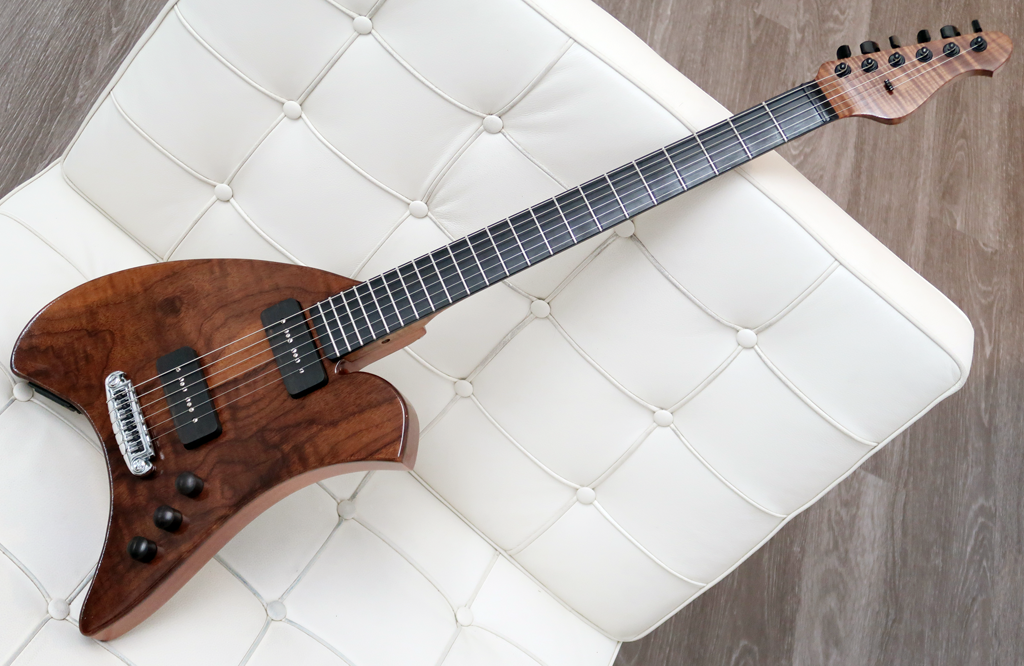

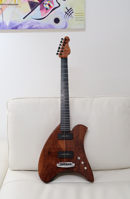

Custom CNC build finished!
Waiting on some special order parts, you know, like strings.  :icon_scratch:
Looks good!

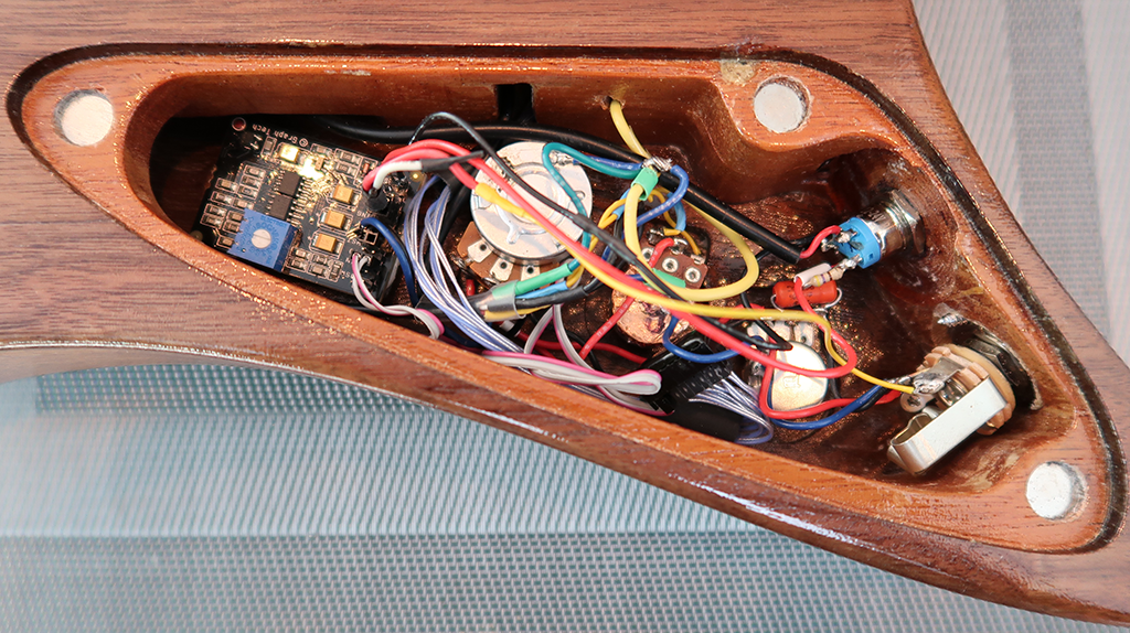

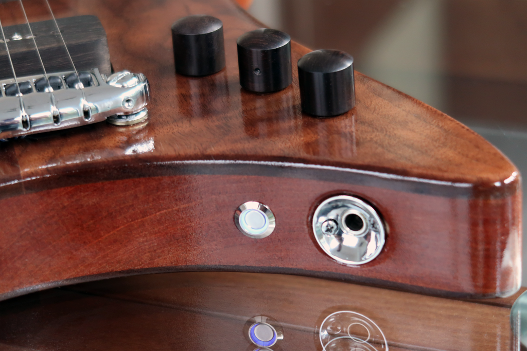

Here's a photograph of the control cavity. Seen from left to right is the Graphtech AcoustiPhonic preamp, stacked piezo/magnetic volume knob, pickup balance pot, no-load tone pot, illuminated preamp on/off push button, and stereo output jack. The piezo and magnetic circuits are completely independent, allowing for the magnetic pickups to operate without the battery. With a stereo cable, the tip goes to an electric guitar amp, the ring goes to a DI box or acoustic amp. A mono cable results in a traditional magnetic pickup-only circuit. With the pickup blend knob, there's no need for a selector switch. The blend knob has its traces cut so that only one of the pickups is in the circuit at each end of its travel.
Very nice piece! You should be both proud and pleased.

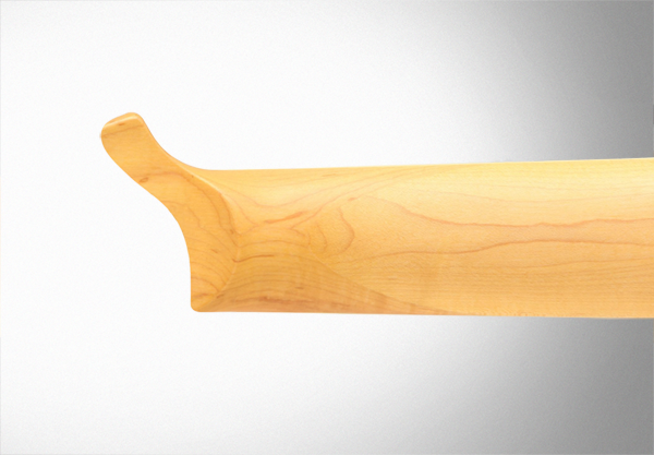

Thanks, I am! Hoping the Austin Markerspace is allowed to reopen soon, as plans for the next guitar are already underway . It's a headless version of this guitar, to be made by cutting the headstock off of a Warmoth neck.
Sounds cruel and unusual, and fascinating at the same time :laughing7:
I've toggled the idea around in my head a few times myself, just playing with my mental blocks. If you haven't, you might want to see if you can play a headless guitar. It's one of those things that are a lot different in real life than in your imagination. Whether it's the bit of a volute, or the necessary widening to accommodate tuners, there's something of a "touchstone" effect of having a tangible end to the fretboard that seems to be important. Perhaps it's something you can get accustomed to - I'm a firm believer in one's ability to get used to anything - but it's pretty weird.
I've played a Stienberger headless guitar copy. You're right about the tangible end to the fretboard. My thinking is to leave a place for the inside of the thumb to rest against. Here's my Photoshop mockup of what I have in mind:
