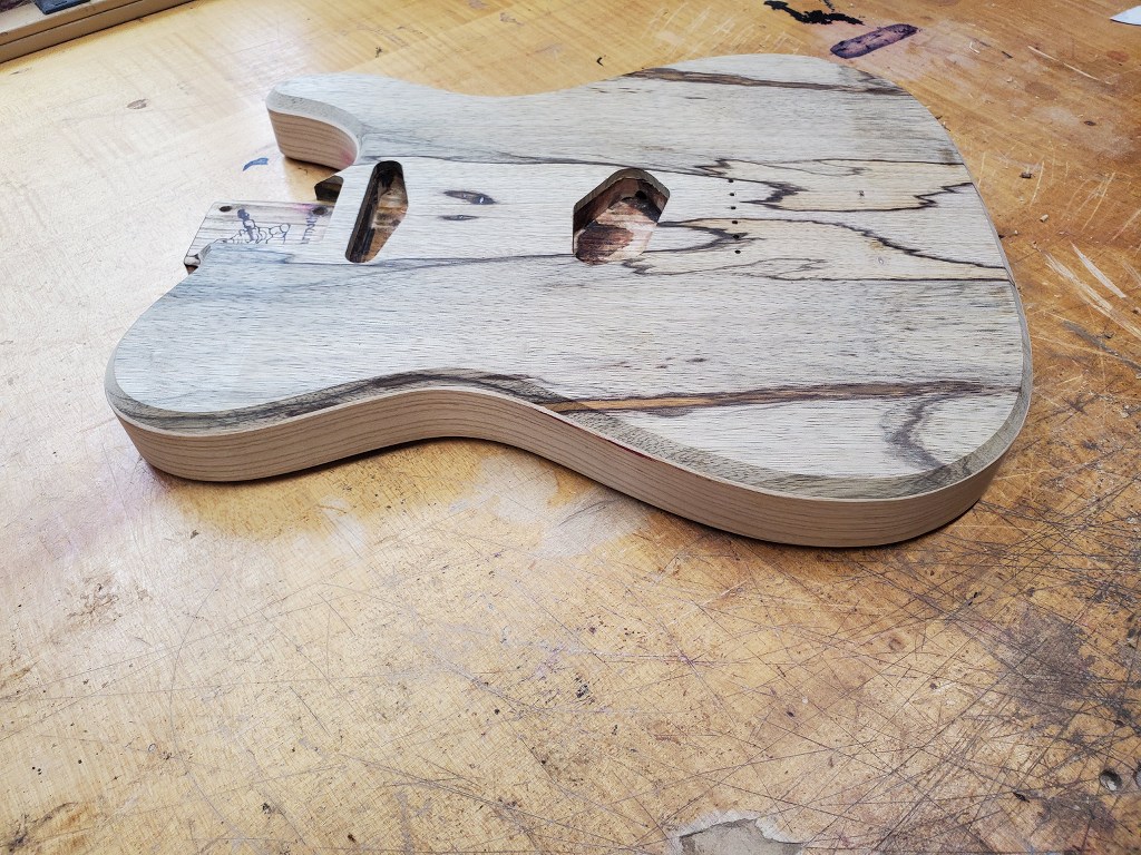

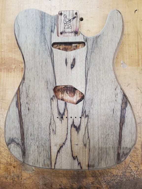

So I ran the body thru my planer and cleaned up the back without too much problem, but the front had to be taken down a good quarter inch to cleanup. Considering that and figuring that the poor thing had suffered undeservedly I decided to give it a new face. So I broke out my Limba stash and glued up a drop top for it.
. This is still rough shape but with some Naptha on it to give an idea.
  Shall see what happens as I go along. As I go through life, my hopes for the Human race go up and down............. :dontknow:
Not quite sure...but I think I see your friend splitting the sheets in that new grain.  If you look real close...yep it’s there.
That should be a spectacular Tele when you're done, the top is pretty sweet.... :icon_thumright:

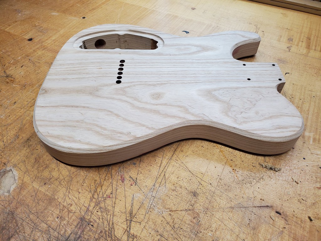

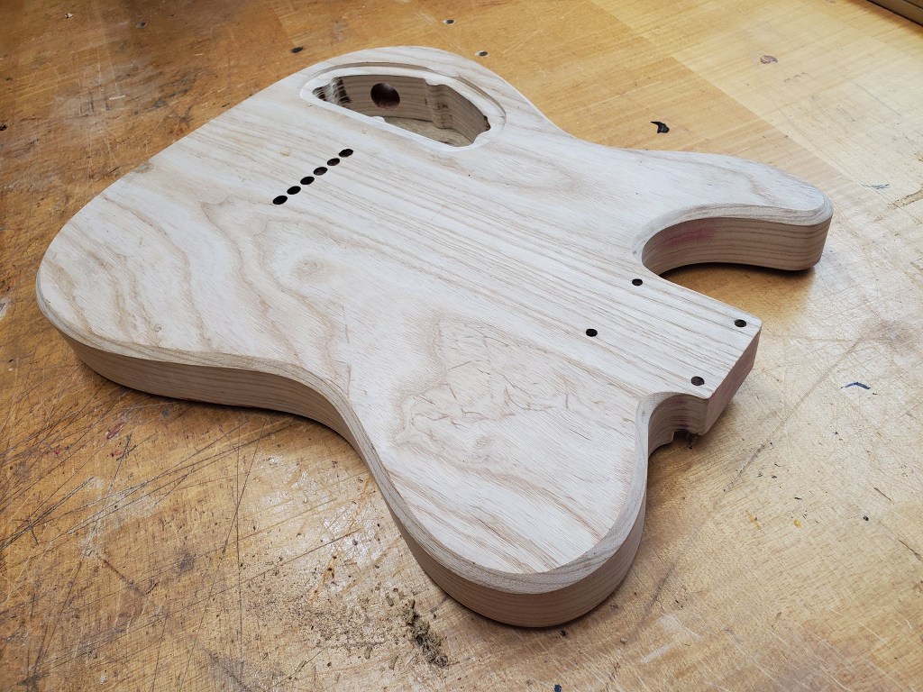

While the other two bodies sit with the oil hardening, I kept busy by continuing the resurection of the unfortunate Tele. We can rebuild it. We have the technology. We can make it better, stronger....Sorry, TV flashback. Anyway I sanded front and back and put a chamfer on the edges. Routed for pickups, decided since the bridge pickup survived I'd just put Tele pups back into it as I have another Tele neck pickup. Converted it to a rear route using templates I made for the job. Don't have any ash to use for a cover so will probably just go with a plastic one. So far, so good.
.  :turtle: :turtle:
That's looking mighty good! The TV reference is a fun one. Nice move to go with the rear rout. Is that a 30 degree or 45 degree chamfer?
Do you have enough of the top piece left over to make a cover for the back?
