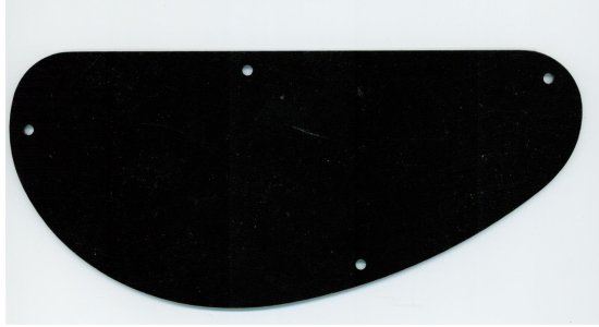

Seems to be using the same cover as most rear-routed Warmoth bodies.
I am not willing to share the vector template I did to make my wood covers, but all you need to do your own is to scan your plastic cover with a basic paper document scanner.
As long as the scanner is accurate (i.e. DPI set properly on the image) you will be able to then trace it in a free tool like Inkscape.
I'll see if I still have the scan of that cover somewhere though.
Attached. If you import in Inkscape it should already be true to size; well... assuming the forum isn't massaging JPG attachments in any way.
Back face down, because that's kind of what you want to position the holes correctly prior to counter sinking.

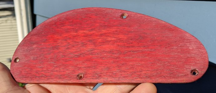

@drseb, that's a handy thing, I'm inspired to take it and put together a drawing for laser cut color plexiglass covers as an alt control cover (side benefit of showcasing my rat's nest approach to wire routing ;-) ).
Also, @seb's covers are awesome, here's mine, not mounted 4 now because I'm still fettling that wiring rat's nest.
