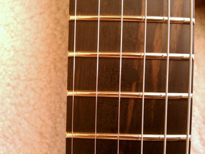

I'll get a photo of my new macassar fretboard up shortly - it's got a nice chocolatey streak that runs the length of it.  Mmmm, delicious!
Sometimes ebony will not be all black.  It can have some brown streaks.
