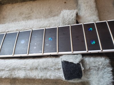

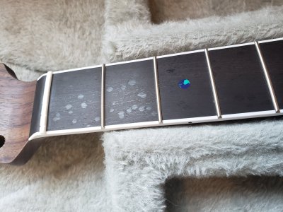

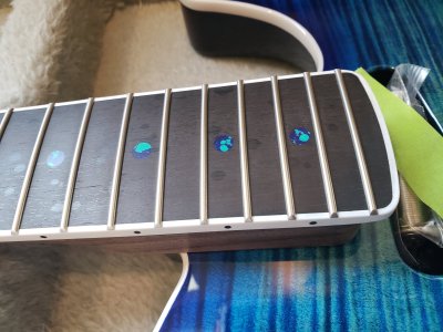

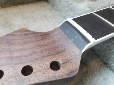

I just received my new neck (yea!) but I noticed a lot of spots running the length of the fretboard (booo!).  It looks like a chemical was splashed across the fretboard prior to installation.  (See attachments)  Has anyone seen this before on a Warmoth neck?  I have another Ebony neck from Warmoth and it is perfectly clear.  Any ideas?  I have emailed customer service and am awaiting a response.

Hmmm.  almost looks like there was some kind of mineral oil splashed on it.
and no, I've never had this kind of issue with my necks.
These are NOT mineral spots. Someone splashed something liquid on that neck, and someone SHOULD have noticed at the factory.
I understand Warmoth is quite the sweatshop. They work those poor little kids like galley slaves, with infrequent feedings or potty breaks, which is probably how you got that neck so fast. Those spots are probably the oily residue of sweat droplets and salty tears. A little naphtha will clear them right up. They usually do that before shipping, but the slave joyful worker assigned to that job is currently undergoing (ahem) re-education. AND THE BEATINGS WILL CONTINUE UNTIL MORALE IMPROVES!
Edit: Naphtha or mineral spirits are your friend here. DO NOT use acetone (lacquer thinner), or you'll destroy the binding.
Any recommended brands of Naptha mineral spirits? I certainly don't want to ruin the binding.  I'm in Southern California, if that influces the choice...
I've never been particular, other than preferring naphtha. Being just down the street, Lowe's choice of inventory influences my decision more than anything. I'm not sure there's a great deal of difference between brands on those chemicals; they are what they are. It's like buying aspirin - you look for the container size more than the brand name.

See if you can get denatured alcohol (not isopropyl). That should work without affecting the binding.
