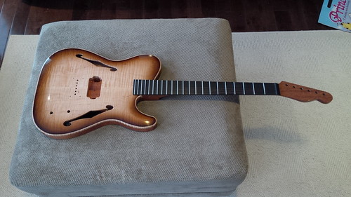

I just want to say (before I get to the deets/pics) that I remember sending a crisp $2.00 Canadian dollar bill (or was it $5...hmm) back in the 80's to a company called Warmoth that advertised in the back of GFTPF.  They did send me a catalogue (even though I sent them funny money, and the ad insisted on US funds).  I kept that catalogue and drooled over it for the next few years.  I lusted after my dream build for 20 years after getting that catalogue before I got around to building in my 30's.  This is my 4th or 5th build...not sure...great company, great staff to deal with and a great forum...thanks for what I am sure will be a lot of kind remarks and suggestions.  Cheers!

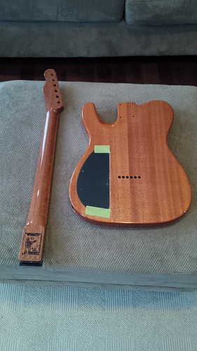

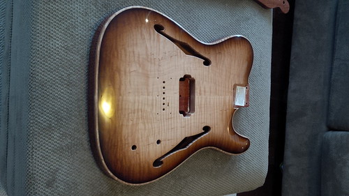

Body
Carved Top Tele
Flame Maple on Mahoghany
2 F Holes
Contoured Heel
720 Mod
Brown to Clear Burst
Neck

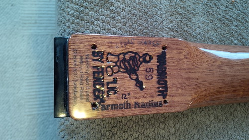

Pro Conversion 24 ¾” Scale
Mahoghany with Black Ebony Fingerboard
1 11/16” Nut
59 Roundback Profile
Stainless SS6150 Frets
Black TUSQ Nut
12” Radius
No inlays, Side dots only
Misc
LR Baggs Fixed Piezo Bridge
Bare Knuckle “Mule” with Nickel Cover
Schaller Locking Tuners
Ebony Pickup Rings/Knobs
FRONT 1 by orldea, on Flickr
TOP 10 by orldea, on Flickr
TOP 12 by orldea, on Flickr
TOP 25 by orldea, on Flickr
TOP 4 by orldea, on Flickr
TOP 1 by orldea, on Flickr

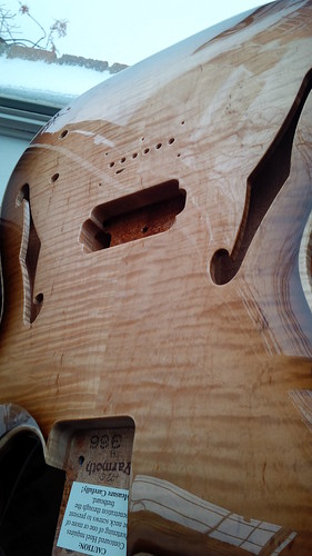

Very sharp! I loves me a carved top Tele. This one's going to be exceptional.
Well, the kids are down to bed (girl 3, boy 1) and I knew there would be some comments.  Thanks.

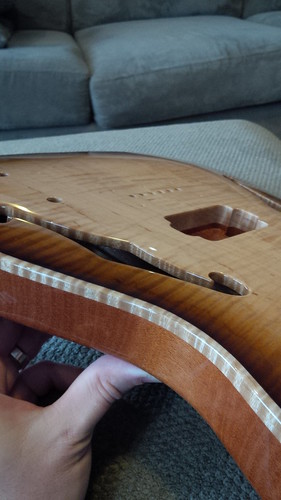

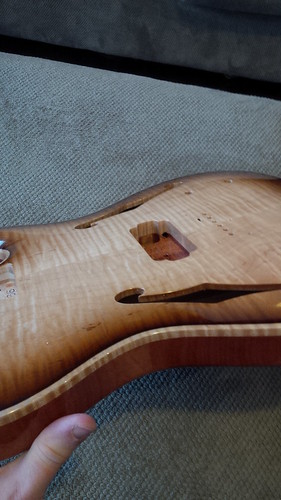

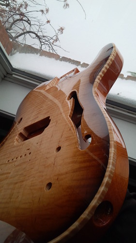

The choices for wood and shape (telecaster "ish") are pretty tradishional.  The inspitation for this build came from a PRS hollow body (with piezo) that I tried in a guitar shop...mahoghany, maple cap, rosewood and ebony neck...conversion scale.  I just wanted a warmer sounding tele...a nice 12" radius (ala gibson) with a ebony board (i had a les paul with an ebony board as my only electric for 15 years...i miss that guitar). This is the first 59 neck profile that i have ever gotten.  I have had 4 or 5 necks, and all with standard thin.  I am going out on a limb here, and this is the first neck I have ordered with SS fret (again, just because I am listening to you guys).

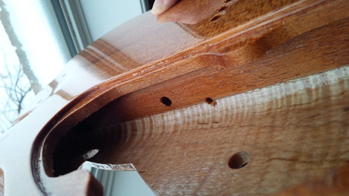

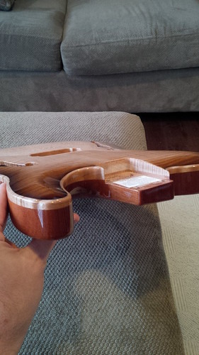

If anyone ever accuses you having a cheap veneer, just pop off the control cavity cover and show 'em this angle.
[/quote]
I am so glad that I sent the body and neck back to warmoth for finishing.  I was going to tru oil it myself (first timer here) and I just got afraid I would mess it up.  I just love the flame maple binding.  It is inspiring to look down and see all those flames "peeking" out from the edges.  It is a nice flame...the charactor of the lines around the edge add alot of personality.  The top has some mineral streaks.  It is not a "10" top per PRS standards, but I like it.  The inside of the cavity control actually gave me a bit of a chuckle.
Cagey, I had a hard time finding good pics of the actual contours of the carved top teles.  Your pics helped me the most in making up my mind.  I really wanted a PRS type of guitar with a bit more of a traditional shape and headstock (something about the PRS lower horn that always bothered me...and the headstock is fine, but borderline "pointy" imho).  The choices of electronics in this build are minimal.  There is one volume for the humbucker, and one for the piezo...no tone.  I haven't used my tone knob for 27 years...why would I start now...lol.  Why only one 'bucker?  I personally can't remember a time I have used the neck pickup.  I know it's simple.  I like simple.  Too many knobs and switches, and I get confused...lol.

Very nice build, really like the brown to clear burst.  Quite unique.
I have more classic though somewhat similar build - carved top tele / conversion neck / 12" straight radius / ebony with SS frets.  It makes for an extremely comfortable guitar to play.  I'm sure you'll love it.
