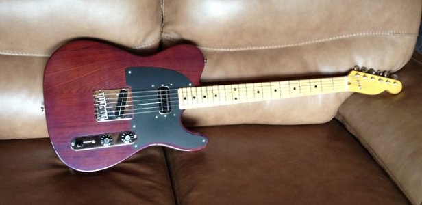

I've been kicking around the idea of some mods on this guitar. Probably one of the first is gonna be a mod that Bill Kirchen (of Hot Rod Lincoln fame) does with his Teles, where he switches around the switchplate.
This is one of the best mods I ever did on mine. I wouldn't have it any other way again. Just remember to reverse the control pots and turn the selector switch around. I also put Fender amp knobs on it, which I also like.

Yeah, I know about switching around the selector and the pots to make sure it all works out. I'm wondering, as long as I'm in there, if I might should swap out those components with something better than comes on a Chinese-built Squier. At least OEM American Fender parts.

Well, when it comes to blade switches, I feel like you can't beat the CRL-3 or CRL-5, but for pots, why not go all out & stick some Burns pots in there?  Isn't your tone worth it?
On the rutters plate, it was an easy $35-ish that I felt was worth it.  They also move the nearest pot-hole over 3/8" to give your finger some room to get in there.  It is very ergonomic, feels so much more natural than the hard right angle of the traditional Tele plate.
