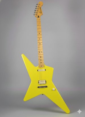

OK, imagine this left-handed Star body with a baritone neck (and a trem) and you'll know what I am scheming about now. 🎃
Gemini AI tried and tried (about 9 times) to edit this picture to provide a 24-fret baritone neck, but just couldnt do it, and It had ENORMOUS problems removing the dot inlays (either did nothing or removed the entire neck!) . It basically gave up and slinked away on about the tenth try...
