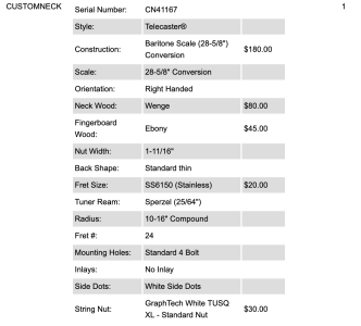

I’d been wanting to do a baritone Tele build for a while, a few weeks back I put in the neck order, and just the other day I got that beautiful shipping notice!
Wenge baritone neck with an ebony board, stainless frets, no inlays.

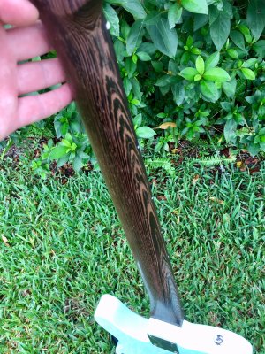

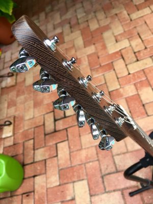

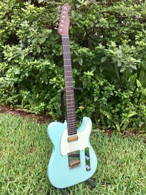

Here we have it! I managed to get some good pics (for me anyway) of the shaft and headstock grain, and a somewhat-ok-ish shot of the full guitar. It really is a beautiful piece of wood, I think I got pretty bit lucky as a lot of wenge just isn't this pretty!  :toothy10: :hello2:
I'm having a lot of fun with this guitar, I may try to add a bass rolloff/contour knob, mainly for the series wiring position.
And as for the body; I thought maybe I'd stick with the current (Squier) body, but I've discovered that the bridge is drilled just slightly off, which I guess gives me an excuse to upgrade.  :dontknow: I'm thinking an ash jazzcaster body is in my future, and I think I'll be attempting the finish. Either natural/slightly tinted, or maybe a subtle grey or aqua colored stain.

That's a very handsome axe.  Nice work indeed!  Particularly handsome figuring along the thumb-side shoulder of that neck.  Wenge can do some beautiful things.
That's certainly a spectacualr neck. It pushes me towards wenge for a future purchase. The whole guitar is beautiful. I like the darker neck with the lighter body. Congrats.
That first image is making my brain feel totally freaked up. The perspective makes the neck look as long as a sexy leg on an amazonian princess. #McLovin'It

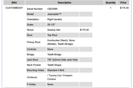

Well I've been testing some stains on ash, and may have accidentally gone ahead and ordered a body and a matte black pickguard to go with it :toothy10:
I'm still testing the options, but I'm thinking the finish will be a subtle stain using a tea concentrate that I cooked up, coated in either tru-oil or some other satin-y wipe on/brush on finish. I did as similar finish with good results on a small pine shelf that  I built. Anyways, I am very excite!

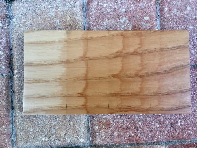

Did some stain/finish testing, I think I'll go with natural or a very light tea stain.
Here is my board with natural, 3 coats, and about three coat increments, (last couple are darker than they look in the photo).
Then sprayed with a light coat of waterbased poly (keeps the brush on finish from messing with the tea stain), and two brushed coats of General Finishes Endurvar flat. While I like the tea stain, I think natural is more the look I'm going for. I may try a single coat of tea stain.
Also, looking at it up close the open grain doesn't look great, I'll have to try some grain filler.
Next round: grain filler natural vs grain filler and 1 coat of tea. :party07:

Looks good. My preference would be for the third one from the left. It has just the right amount of tint to still have that natural look.
My vote is for third-from-the-left also.  Very excited to see how this ultimately pans out, but you're off to a wonderful start and middle-part.

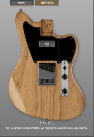

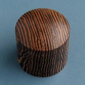

So this is my mockup of pretty close to what I think I want the body to look like, but with three knobs, what do you guys think about knob color; chrome, satin black, or maybe some fancy custom wenge knobs to match the neck? (second pic) Or maybe something like brass to match the brass to match the brass saddles and goldfoil pickup?
Still working on the finish/stain tests, I'm also going to give Tru-oil a try

My choice of knobs would be black but you don't have to please me. Choose what you like the best and that's the proper choice.
