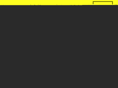

OK. Here is my mock up of how I plan to wire my Hagstrom Swede ... it's on the post two down from this one.
I've got new pots, new caps, vintage braided-shield single-conductor cloth push-back wire (whew, that's a mouthful), 60/40 solder and a dream.
The one thing I don't have, that I wish I did have, is a mini-toggle to replace the stock tone-filter switch, but that should be easy to swap out.
I'm trying to avoid soldering to the backs of my pots while, at the same time, getting to ground every connection that requires it. The red wires represent the hot wires, which would be the braided vintage wire, the gray wires are ground wires (whether bus wire or insultated single conductor wire) and the blue dots are solder joints on the braided shield.
Constructive feedback, as always, is appreciated.
My paramount question here is: Does soldering the spare lug to ground on a pot serve to ground the pot, itself? I have my doubts. I expect that I'll need to use the four solder lugs Cagey gave me.
Also, I left out the bridge ground wire.

I screwed up the diagram. Living in a right-handed world, I wired it according to a right hand diagram, which put the hot lead from the pickups into the end terminal of the volume pot, and everything else was screwed up, accordingly.
As for wrecking things ... how so?
I have my entire guitar gutted. When I want to test something, I hook a test lead to the ground wire of the pup and the bridge ground and hook that to a bus wire. I hook the ground terminal of the volume pot to the same bus wire, and then run another test lead from the bus wire to the ground sleeve of the jack. I hook the pup's hot wire, again with a test lead, to the volume pot, run another test lead from that same terminal to the tone pot's start terminal and, then, run yet another test lead from the pot's center terminal to my cap, which is connected to the bus wire with another lead.
I get no hum, even with the mess of test leads connecting everything. The pots aren't grounded except by the wires attached to their terminals...
Of course, above, I'm describing "Modern Wiring" but, below, I'm depicting "'50s Wiring."
You asked "does soldering the spare lug to ground on a pot serve to ground the pot, itself?" and the answer is no. And in fact, you will change how the circuit works, if it works at all.
Think of it this way: there are no "spare lugs" on a pot; only unused ones. But, the unused lugs are still connected internally (not to ground), so you can't just hook them up to whatever you want. It will affect other things that are connected to the pot.
Now, if the pot's housing is grounded, either via ground wire soldered directly to it or through a ground lug/terminal, then if you need one of the pot's lugs to be grounded, you can certainly connect it to the pot's housing to make your circuit. But, you defeat the purpose of using ground lugs if you do that. The object of the exercise is to avoid soldering to the pot's housing.
I understand. I'm certainly not taking any definitive position when I describe my experience with the test lead connections I made. Just that I wired two pots, a pickup, a cap and my jack all together in a way that gave me both sound and no hum, and I did not ground the pot housings in any way that seemed readily obvious to me.
So, ideally, I run a little bus wire to from the normally ground pot lug to the solder lug and then run another wire from the solder lug to my braided output wire, to which the wire to the jack's ground sleeve is soldered. Ah, so.
There you go. And if you stare at all the physical parts long enough to visualize how they need to be connected, a crafty way of running the various lines will occur to you that'll make it all less work. Might take a beer or two, but that's alright. Beer is God's way of telling us he loves us.
