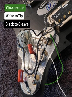

Okay, again, thanks for assisting me with my previous grounding issue of the braided shield making contact with either the copper shield pickguard or tab at the blade switch.
So everything is working correctly, except, when I did the tap test before stringing up, there is an overall hum. A dull hum, like I have an overdrive pedal turned on in a single coil guitar. Volume off makes it go away (duh) and messing with the tone controls naturally dulls and brightens this hum.
The braided shield was stripped back to the grounded pot, so nothing to affect pickup wires interferring. I switched from the original Alpha pots to CTS 500k. All components are new (CRL blade switch, switchcraft output jack.)
I’ve added a wire from the grounded pot attached to a screw, screwed into the body control cavity before. I’m always mindful of good solder technique to avoid the whole cold solder rabbit hole scavenger hunt.
I didn’t take a pic of the circuit with the output jack and claw ground wires. I swear I connected the tip and sleeve wires correctly. But I’ve had similar results when those wires were reversed. God I hope it’s not that (yet still that would be a simple solution.)
No shielding in the control cavity. Didn’t think I needed it with humbuckers.
Again, lots going on in my life, working on this guitar was supposed to be a life distraction, but somehow my focus is off for troubleshooting. You’d think after 25 years of wiring circuits I’d have this down in my sleep by now.

The guitar volume eliminating the hum is not necessarily a “duh”, as a hum could potentially originate elsewhere in the signal chain. So that is a valuable data point. Did the tap test produce the expected results (pickups active as expected for each switch position)? Is the hum present in all switch positions? Does the hum change/stop when you touch the strings or other grounded metal component on the guitar?

Test showed all appropriate pickup positions. Hum was present in all three positions. No disappearance of hum when touching any metal parts.

Yes, ground from claw to volume pot.
The next thing I would do is use a multimeter to verify continuity from the jack sleeve to each item that should be seeing ground: pot cases, grounded volume pot lug, the shielding foil, the trem claw, the bridge itself (which should be seeing ground through the claw), the switch frame, the pickup frames, the braid on the leads, and whatever I may be missing. It should all ring out with the jack sleeve. If not, investigate. If everything checks out there I would be starting to suspect a cooked pot. I’d disconnect the switch output and the jack tip from the rest of the circuit and go directly from the switch to the jack and see if the hum is present.
I'm probably wrong, but the black wire coming off of the 3 way switch, looks to be used as a ground. Is that correct?
For myself, I don't recall a ground coming off of a switch.
edit: I think that is the conductor wire coming out of the braid, rather than a wire going to ground
All good advice above. The bare wire being used to bridge the switch, could that be contacting unintended parts of the switch (or its solder)
No. Although the wire is cloth, it’s pretty ridged and stays in place. I wouldn’t think the insulated claw, sleeve & tip would cause problems with contact. But I could be wrong.
