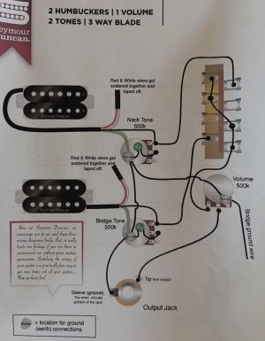

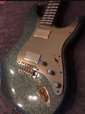

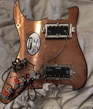

I’m wiring up a Strat with HxH single braid Lollar Imperials, 1 Vol w/treble bleed, 1 Neck Tone, 1 Bridge Tone, 3 way blade switch. Straight forward.

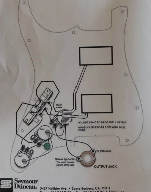

Initially the Seymour Duncan wiring diagram resulted in bridge output while in the neck pickup selection, dead in middle & “bridge” position. Instantly thinking I reversed the wires at the switch. Same results, bridge pickup output, no neck.
Now I’m thinking, I’ve got a cold solder joint somewhere. Checked all solder joints, same results. These are brand new pickups ordered directly from Lollar. I’m using Alpha 500k pots since I’m using Q Parts Dome control knobs, due to their 6 mm fitting. No removable copper sleeves in these knobs to fit the 6.33mm CTS pots.
I might mention that there was no hum while manipulating the control pots. I’m now thinking I may have possibly cooked the Alpha pots while solder grounding the shield braids or grounding “chain” wires. I’m only using a 40 watt soldering iron. I have cooked pots years ago as a nubbie.
Replaced the pots and tried other approaches. Since the Seymour Duncan diagram, no matter what schematic I follow, I now get absolutely nothing. No output doing tap tests. No hum when touching metal parts on the guitar. I have since tested the pickups and the neck pickup is reading 0.00k. The bridge, reads 8.35k. Yet, no bridge output once wired up to the switch.
Then it occurred to me..

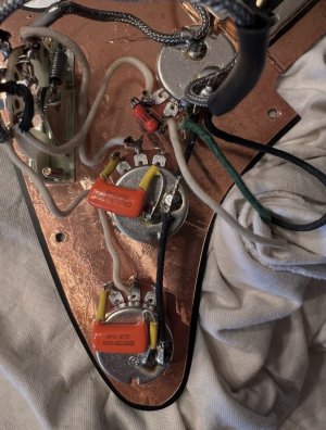

The entire back of the pickguard is covered in adhesive backed copper shielding. Could this be canceling out the signal? All components are brand new, not sitting in a junk drawer.
I’ve never used anything other than CTS pots. My blade switch is an Oaks Grisby, and the mono jack is from Switchcraft. I’ve never had any reason to test pickups from Lollar. I always test if I’ve purchased second hand from Reverb or eBay.
I’ve been wiring circuits for 20 years and I’ve never had so much trouble getting a circuit wired up. The only thing outside of my usual process is the Alpha pots and the copper shielded pickguard. Everything else is exactly how it’s represented in the diagrams. I did switch solder brands. But I doubt that’d be the problem.
I never over solder, always going for nice shiny bead drops. Pre tin the iron tip, preheat lugs prior to introducing solder. I feel like I’m loosing my mind. Let’s problem solve!

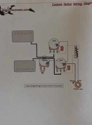

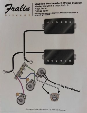

Current wiring reflects the Fralin schematic for reference.

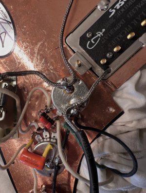

It looks possible to me that the braided pickup wires are grounding signal when all crammed into the route.
Crammed? The pickup wires are pretty rigid. I’ve moved them out to avoid obstructing connection points on the pots. The only contact between braid & neck tone pot is covered with heat shrink. But even still, typically a contact like that produces a loud ground hum. This circuit as it sits is virtually silent.
But, since you mentioned it, I will plug in while the pickguard is detached. I think I’ve been too lucky all of these years, wiring circuits with no mistakes. It has really robbed me of troubleshooting solutions.
There’s clearly something grounding out the signal when the neck is engaged based on the symptoms - the shielding is fine to share as many grounding points as you desire. My guess is some solder is accidentally bridging your signal and ground either on the back of the pot or at the switch connection in this part:
If that’s true, I’m guessing either at the grounded tab, since it’s also sharing claw ground and jack ground, or same below the switch connection lug underneath towards the lug tabs? Plus my neck pickup is not picking up any k readings. Just the bridge.
Any contact locations to check with my multimeter? Something to isolate the chain of flow? Also, I appreciate you taking the time to even answer my post. I have this gut feeling it’s something obvious and I’m just stuck in my head. Lots going on in my life at the moment.
Yes it could hum OR be dead silent. Have you re checked the output jack?
I don't think shielding the pick guard will cause problems, but I've had problems from shielding body cavities. Somehow a lose wire touches the cavety shield.
Also, as an aside it's odd the neck pickup wire emerges from the right if that is a neck pickup. That isn't a problem but interesting.
Check or ohm meter each pot leg to the copper shielding. The tangs for the pots are very close to its mounting surface. A slight bend would contact the copper foil, or there could be a small piece of foil from the hole cutout hanging around. I put a small piece of electrical tape between the pot tangs and the copper shielding in my builds.
Check or ohm meter each pot leg to the copper shielding. The tangs for the pots are very close to its mounting surface. A slight bend would contact the copper foil, or there could be a small piece of foil from the hole cutout hanging around. I put a small piece of electrical,tape between the pot tangs and the copper shielding in my builds.

Regardless of which diagram is now in use, Is it possible that some solder is making an unintended contact within the switch itself or the switch itself is faulty?
I find it weird that it would be a high quality CRL switch, but I’m thinking there might be a glob of solder that slid down into the terminals underneath the top tabs. Might be time to get stronger reader glasses while soldering. Decreasing eyesight acuity has been becoming a factor that once was my an issue before. This is what makes me think this malfunction of signal is user error.

I thought Hodgo was onto something and the neck pickup might be shorted out.
You can test that with a MM: With the pickup switch in bridge position, measure between the lug where the neck pickup's lead ("hot") is soldered to and the braided shielding or any other ground. It should read the neck pickup's DC resistance.
If not, maybe hot solder has melted through the insulation shorting the pickup out.
Hmmm, good point. Perhaps the braided wire is touching the copper shielded pickguard when closed up. I will definitely plug in with the pickguard assembly off of the body and see if making contact with that shielding produces a cancellation of signal. Thanks.
Another good point made. But the neck pickup was disconnected from the switch, then tested with the MM. 0.00k.
I’m gathering all of this useful intel and at least I’m now armed with a direction to start the process of elimination. This is why I pay for the higher quality components, so that I can remove the component tolerance fail factor. But honestly, I’ve never worked with Alpha brand pots before. I’m uncertain of their heat dissipation tolerance. Love CTS. I might need to forsake the Q Parts knobs for aesthetics and switch back to basic knobs that fit the CTS solid shaft pots for this build.
