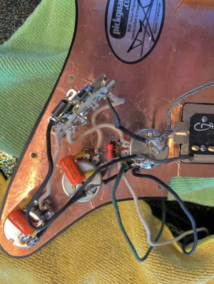

In this pic, it appears to my eyes that the braided shield may contact the #1 or #2 terminal unintentionally when the hood is closed.
That’s just an in process build pic. Notice nothing is soldered to the pot yet. All loose wires at this point.

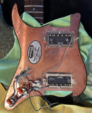

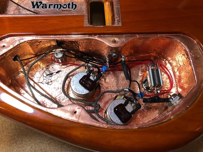

It Works!!
Replaced the switch and noticed two places where some solder blobbed its way down the tabs from the lugs. But I wasn’t finished there. I removed the pickup braid shield from the tip wire to the grounding solder at the pot for both pickups.
Guess what? Now I have full readings on both pickups. So the neck pickup obviously was grounding out either by making contact at the lug or touching the copper shield at the pickguard.
Everything works now. It was just a bonehead mistake. Thank you for everyone’s input. Now I know why people hate Gibson style shield braided pickup wire. I appreciated everyone’s respect unlike some other forums.
